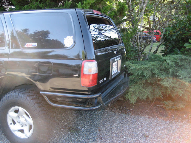

Also, on the rear bumper, while I really dig Scott's bumper it's really nice to have a place to sit under cover/shade with the rear hatch open. So I had my fab guy bring out the rear about six inches and it also gives some good protection to the hatch.
