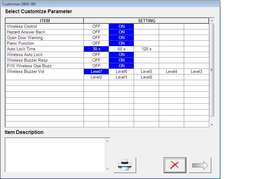

Iirc you can do it in TechStream so you can DIY or get it done by the dealer. Carista may also work.
Stole this pic from the TechStream thread...

I used Carista to turn it down to level 1, I think there was 6 levels on it. It's good to have some audible in the event another door is not fully closed when you lock the truck and it emits a long warning tone. My 2 cents ...
