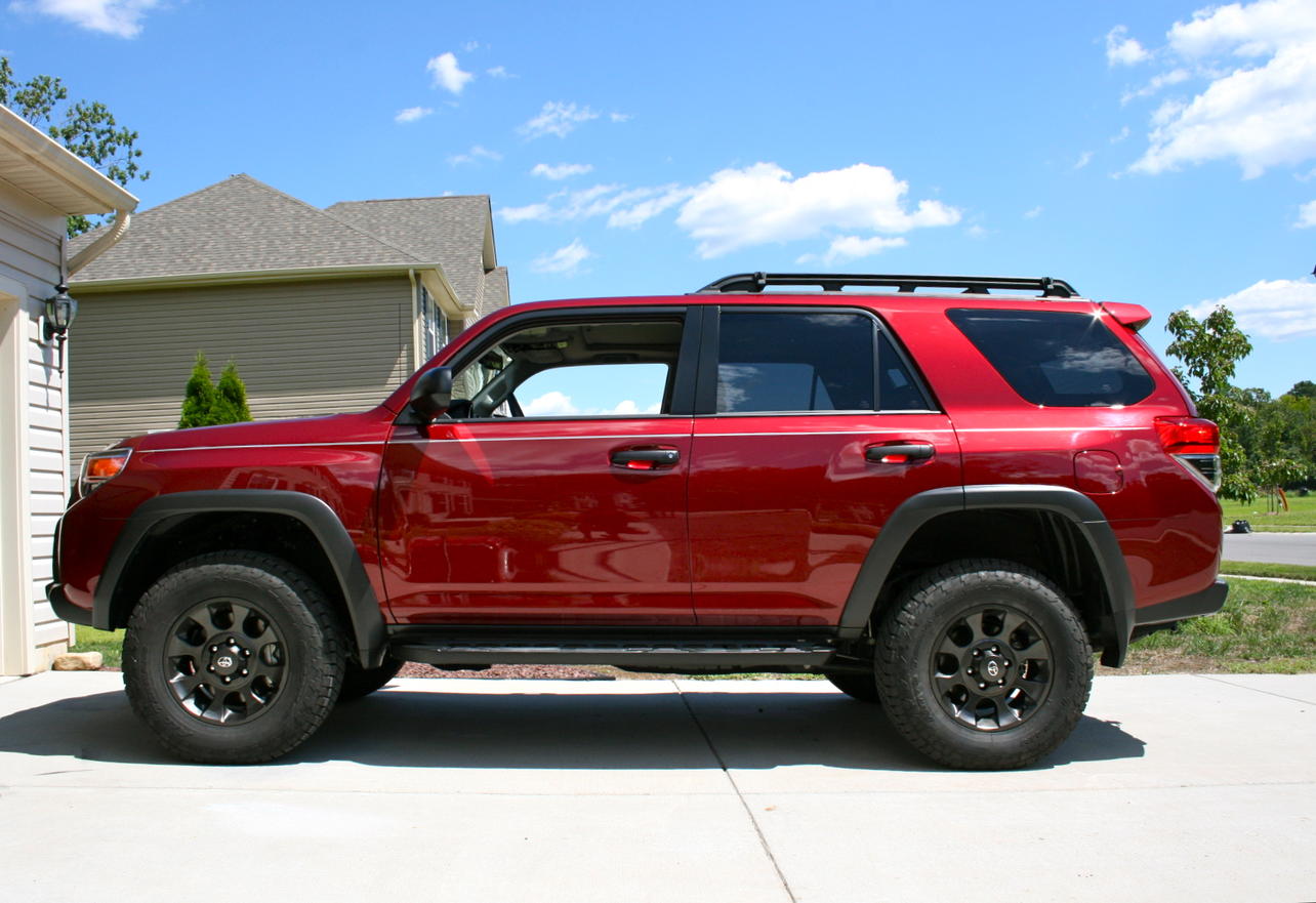

I have 1.75 set up with 1.5 rear spacer at stock tire size.Sorry pics not level.

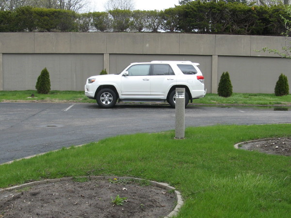

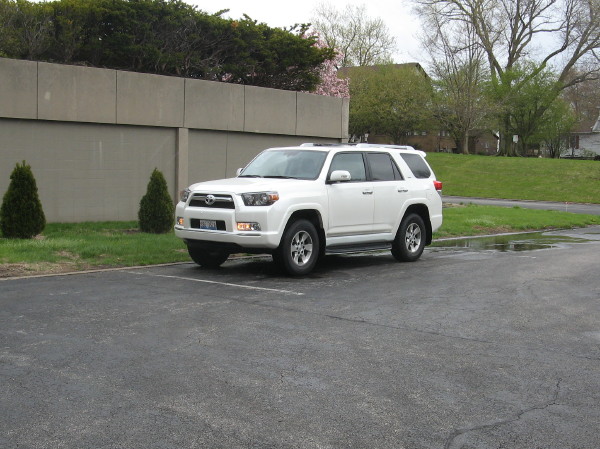

5100's w/ .85 front, zero back, oem tars.
Very nice! Great color too, seen a lot of new 4R's around, but only 2 red, both were SR5's. Thanks for the photo.
Do you have a 'side on' shot of your rig like that? Would be perfect to compare to BatangSMB's!
