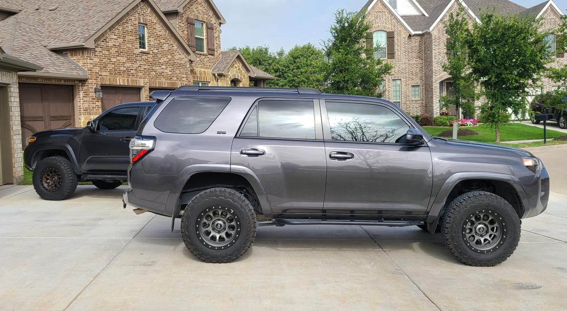

I have 5100 all around, blistien 1.5" coils in the rear, OME trim lean spacer 0.4" on right side and set the perch to highest setting. Front sits about 1.25inch lower than rear.

You can use stock coils for the front. If you use 1.5" coil lift then you would set the perch setting to the top 2 in the front.
Wow. What a sweet ride!
Yeah this same height i want. #2 settings would be 1.75 front right?
This is new for me and want to get it right the first time.
Thank you Panda!
