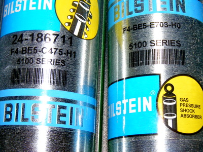

Depending on the website selling these. There are two sets of parts numbers. The numbers you have are correct. Bilstein has a spreadsheet with cross reference to the new numbers.
New Numbers
Front 24-186711
Rear 33-187174
This might explain some of the inconsistencies.

I have the 5100 setup on my T4R (~5000miles now) - which I purchased from Shockwarehouse. Seems they do not carry the 5100 rear anymore. The part number you list for the rear is the Heavy Duty (HD-yellow model). However, these shocks have the same exact valving as the 5100 and don't worry, it's not visible unless you get underneath. The difference between them is the 5100 is longer to accommodate a 0"-2" inch lift - can't use the HD on a lifted rear. Also, if you want to spend a bit more there's the new Bilstein 5160 rear reservoir shock and different valving. I have a issue with the rear being a bit bouncy and I hope to soon change the rears out with these. I did not lift the rear and I had to put the spring perch to the 0.75" lift setting to about a 1.5" - 1.75" lift. I thought I had this issue because my thinking was the V8s had stronger front spring rates, but I think there are others with V8s that got the lift to what Bilstein had specified for each level.

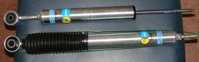

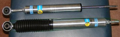

This should make it clear. These are the shocks I received from Billstein (my niece works for them).

How come when I put the part # F4-BE5-E703-H0 (rear shocks) on the Bilstein website, it brings me to this page showing the silver 5100's and not the yellow HD's?

Sorry, yes those are the 5100s. I clicked on the part number on their site and it shows you a pic of the yellow ones. If you click on the "Bilstein Heavy Duty" you get the 5100 pic - go figure.
