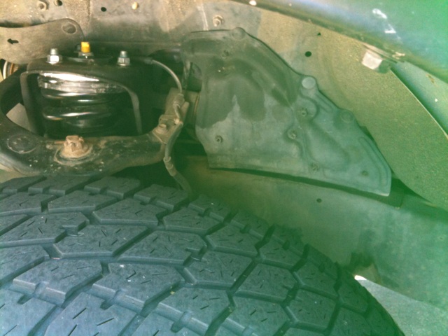

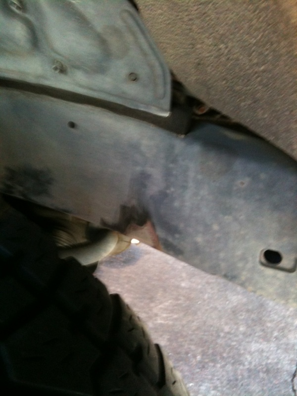

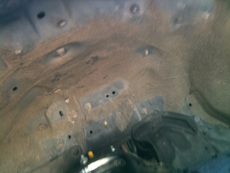

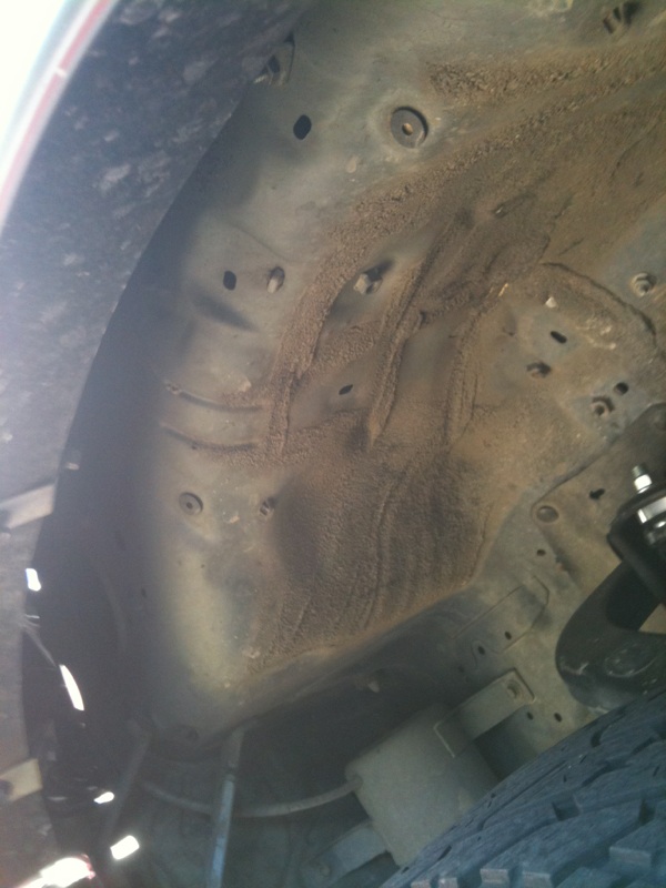

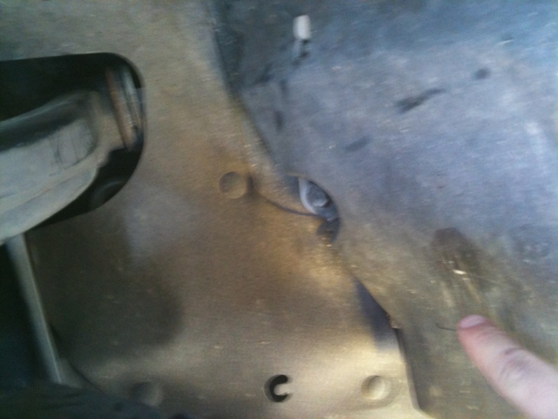

Here you go. One thing to note is that I dont have either splash guard in the front. That might be a contact point too.
I took some shots of the whole wheel well (Sorry iphone quality). You can see the only two known contact points. Them being the frame, and a small rub mark on the front of the passenger well (The one I am pointing at). The frame mark is about 2"x2".
Though, If you got a bit wild on the trails, you might expect to see a bit more.
Hope that helps.

I also neither cut nor trimmed anything other than the removal of the splash guards. But that was irrelevant to the tire installation.
How much cutting and pounding would be required? I really want 285's. I'm planning to get the OME lift eventually, but it will be probably another year before that's even a possibility.
Fully compressed is fully compressed so in theory, you shouldn't really have to cut or pound anymore than the rest of us do that have lifts and run 33s. HOWEVER....The problem is, most of us do still rub a little at full lock/full compression even with a 3-4" lift. The difference is that for us, the tire has to pretty much drop and fall of a big rock or something to fully compress the shock/coil and then you'd have to be turned all the way to one side when that happens for it to rub. I might hear my 255s rub twice in an 8 hour day of wheelin so it is of no concern to me at all.
But for you without a lift, it doesn't take much at all to fully compress your coils because you have a lot less upwards travel. A bump in the grocery store parking lot may be enough to compress your coils and make you rub (especially if you're turning at the same time you hit it), but I could hit that bump probably 5 times faster and still not rub.
You have a lift though, he's talking about running 285s stock. Or were you talking about before you got your lift on?
"You have a lift though"... still feels great to hear that attached to my 4Runner.
Good call Brian. All this information is from before the lift. That just went in the other day.
The important thing is to be aware of your rigs limitations. This is my daily driver, so I take things slow off road anywho. The less I have to replace because of operator error, the better. I knew of potential rub issues, so I slowed things down to be sure what I could and could not get into.
285s WILL rub, but how much depends on your individual set up.
