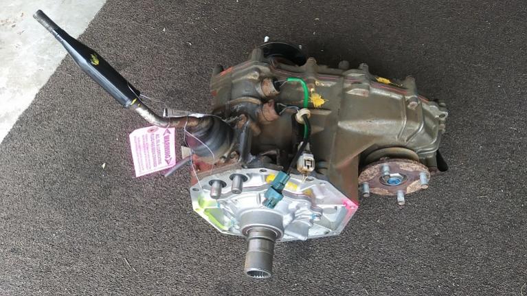

Not ready to do the swap, but went ahead and picked one up while prices are reasonable. [MENTION=459231]xtremewlr[/MENTION] not as clean as yours because of the rust factor here in Fla, but 2012 4Runner-130k miles $205 + $50 core. Didn't have the shift knob but I can probably find one of those cheap enough.
[MENTION=28542]Extreme[/MENTION]wlr not as clean as yours because of the rust factor here in Fla, but 2012 4Runner-130k miles $205 + $50 core. Didn't have the shift knob but I can probably find one of those cheap enough.
Very nice! Mine was a 2011FJ case with the same mileage. No core on mine but I paid the same overall price, $250.

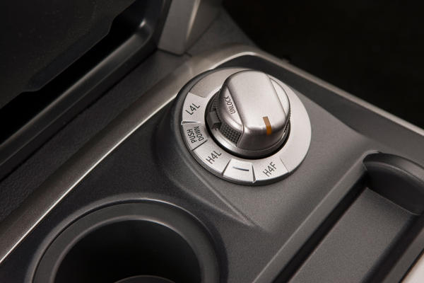

I think the 5th gen case would be the same in all of their manually shifted part-time options. (Early Trail, TRD Offroad, TRD Pro) My 5th gen Limited AWD is a little different than my 03' V8 in that there is no separate switch in the dash for the center diff lock. The t-case may very well be the same as my 03' Full time awd, but with the center diff switch incorporated into the console dial. The base SR5 has the dial but is part time so I'm not sure how that one is set up, and if it would work in the 4th gen.

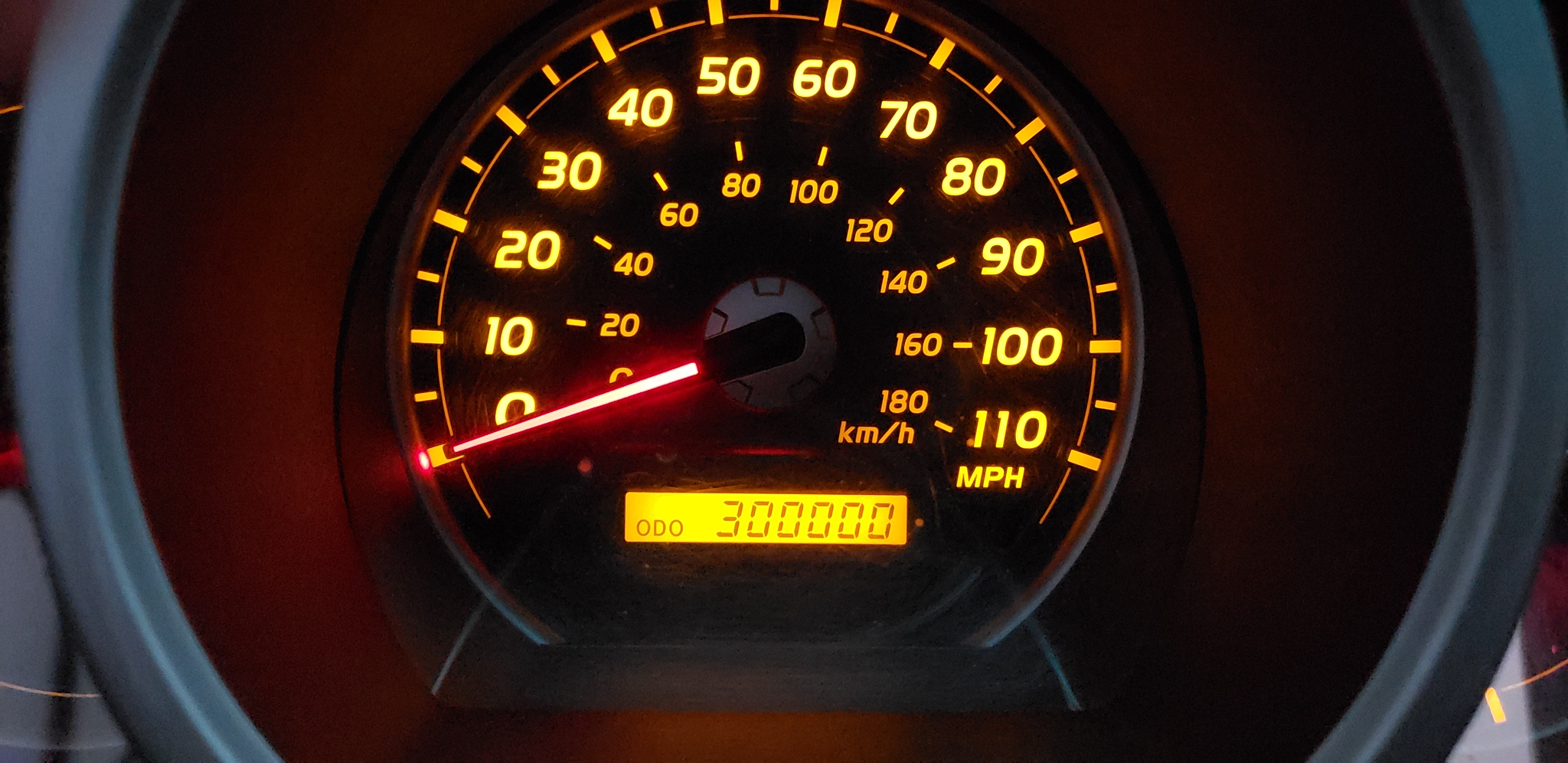

And side note - just over 8500 miles on my swap, with the stock, non-ADD front axle. Nothing has blown up yet. Everything works great still. Turned 300k miles on the 4Runner the other day as well.

That's a center diff switch? I looked at a 5th gen recently and originally thought that's what it was, but it seemed to only be a lock for the dial positions. I just sat in it, no driving, and didn't have time to look closely.
Yea, I probably could have made that a little more clear. Technically in the 5th gen Limited, there is no separate center diff switch like on the 4th gen dash. There is a single dial. It has you switch from 4hi unlocked (Full time AWD) to 4hi Locked or 4 Lo Locked with that dial. And yes you are correct that little button is just a lock for the dial positions.
So basically when you switch from the 4hi unlocked to 4hi Locked, it's doing the same thing as 4th gens diff switch on the dash. It's still electronic servos making the switch in the center diff. That's where I should have omitted the "incorporated" part of my statement.
The manual t-case does not have the electronic servos that go bad. But it stays in 2wd until you move the lever into 4hi, and then the front diff has a system that locks the hubs.
It can be a little confusing. There are threads in here that delve further into a better explanation. I came from the old school manual locking hubs and manual t-case shifters in my old pick ups, so I had to do a little reading myself when I first bought this 5th gen years ago. I may look into putting a manual t-case in my 5th gen Limited in the next year or so also.
Ahhh, ok. I guess I was sitting in a limited. I didn't even look. That dial was the only one I saw.
