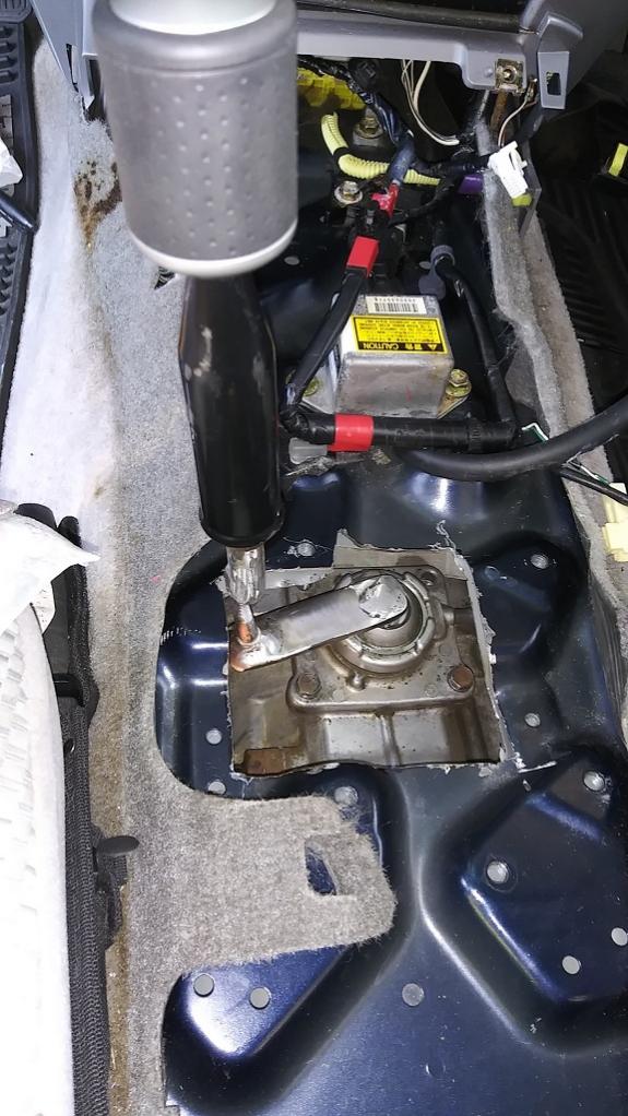

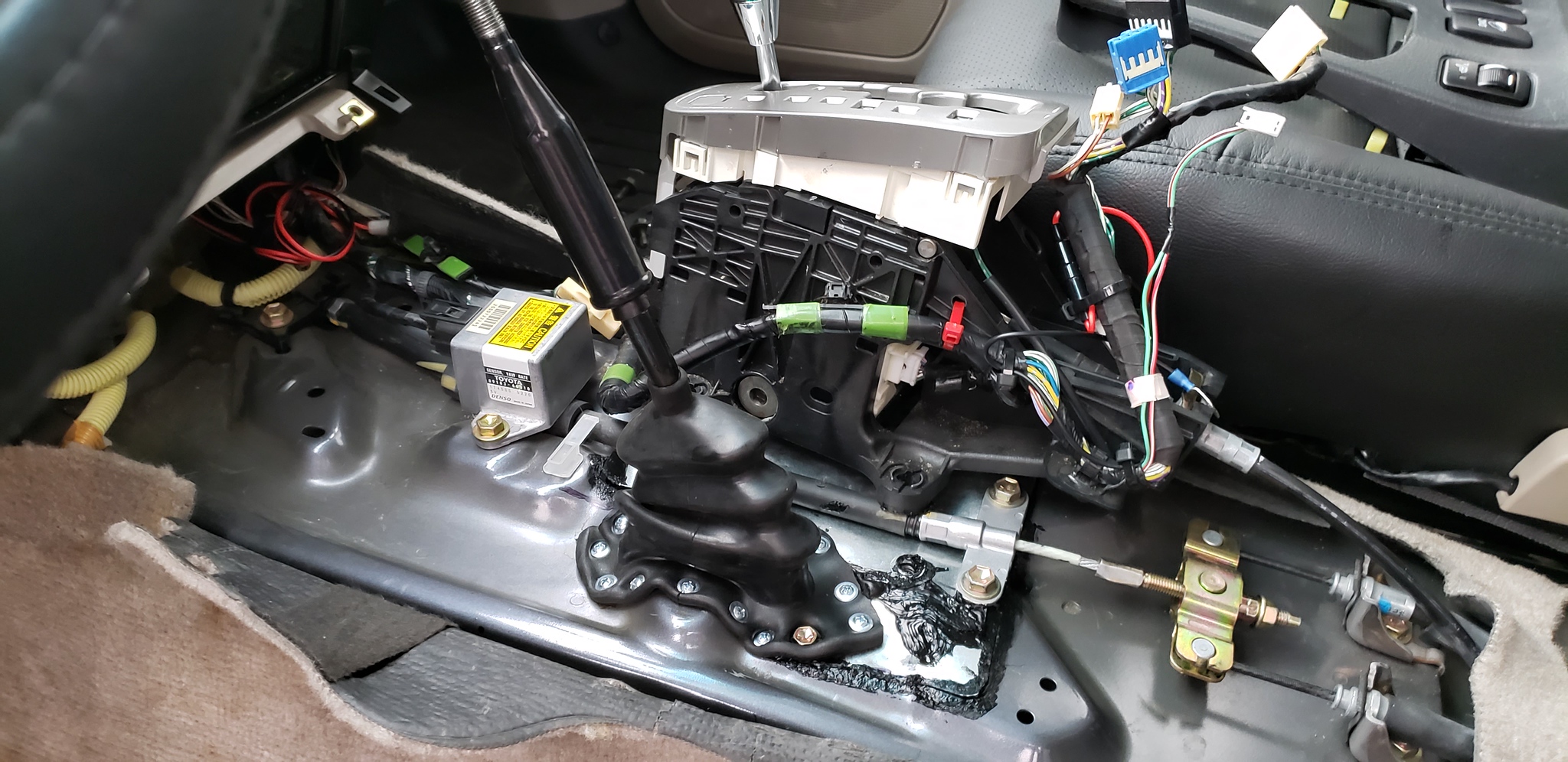

Anyone have a top down view of their tunnel cut and where the FJ stick comes through the tunnel? Looks like it's almost dead nuts under the shifter. Is that right? Anyone thought about moving the trans shifter to the left and having the FJ stick come out where the trans shifter used to be? Or just shimming the trans shifter higher off the tunnel instead of a body lift?
Good Morning, hopefully this helps.
See 4RunnerAquasport's pic above. That is the bare minimum you need to cut out to have the shifter be functional and make it easy to cover up with a boot.
You can't move the trans shifter left easily and probably not worth the hassle of trying. when it's so simple and easy todo as pictured above.
Along with moving the shifter, you would have to make a custom console as nothing from the OEM console would then work.
Shimming the shifter also negates keeping things looking stock with the console. The body lift isn't a requirement to do the swap but it does make it a little easier.
4runnerAquasport and xtremewlr, Thanks for the photo and info. Having that OE finished look that you guys ended up with is key. But a trim ring or bezel could solve that. So forgetting the console side of it. Would you do it differently? Is there room to move the shifter over or space it up or both? I don't love the idea of such a large hole.
Cover the hole with a bolt on plate that you fabricate and use a shifter boot. Easy.
There really isn't room to move the shifter over, it's still going to cover the tcase shifter. You have to cut a hole no matter what. 4runnerAquasport has the smallest hole required to get the job done and be able to access the top of the tcase where the shifter goes.
+1 on the above^
moving the shifter gains nothing, if anything, it will get you further from the "oem" look since your console wont fit/sit right if it moves.
There is space under the shifter to allow for actuating of the t-case shifter, but it needs to be modified. You'll need to cut the the FJ T-case shifter down just about to the boot (depending on body lift) and shift it laterally before you re-do the vertical run to land where you need it. It comes out pretty nicely in the original cigarette lighter hole and with a little attention/work could be closed up pretty nicely with a boot. I was running a twin-stick (which I advise against) and was able to make them work using some flat bar to shift things over, the factory J-pattern would be my preference if I did it again.
The amount of clearance you need to cut for the shifter in the tunnel is really not that much. Like mentioned, 4RunnerAquasport probably has the most minimalistic cut I've seen. I went too heavy on mine and lost one of the 4 mounting holes for the original shifter (but to be fair.. I rushed through it and had the case swapped in in less than a day, if you take your time you could make it much cleaner).

Here is the hole that I cut for this. Note that the trans tunnel is dual layer. I used a jigsaw for the majority of the cutting. Just have a shop vac handy to vacuum up all the steel shavings. You can probably get away with a lot less than this, especially on the side where the shifter is, but it does allow you access to the top of the transfer case for removing and installing the shifter. You don't want the shifter installed when removing or installing the FJ case as it makes things much more difficult.
And the tcase in place to figure out how to re-route the shifter. It needs to clear the bottom of the transmission shifter and come up through the center console where the ashtray/cig-lighter was.
My modified shifter. I stuck with the single stick but you can also go with a twin stick if you want. Ether one will need to be cut and modified to fit. This requires welding so you need to do that yourself or find a welder to work with.
Just make sure the shifter clears everything and there is room to shift from 2HI to 4HI and 4LO. You can then fabricate up a cover for the hole you cut in the trans tunnel. I used some thin, around 22 ga, zinc coated sheet steel from Home Depot and cut it with tin snips and then shaped it as best I could to fit the trans tunnel. It's sealed to the tunnel with black RTV to prevent water from getting inside. Note how small of a hole the shifter actually needs to move through the whole range of 2WD/4HI/4LO.
I also used half of the boot for a twin stick (I have a twin stick for future use if I decide to do so) to make a shifter boot and used self tapping screws to keep it in place and seal it to the tunnel. Maybe overkill but I'm OK with that.
