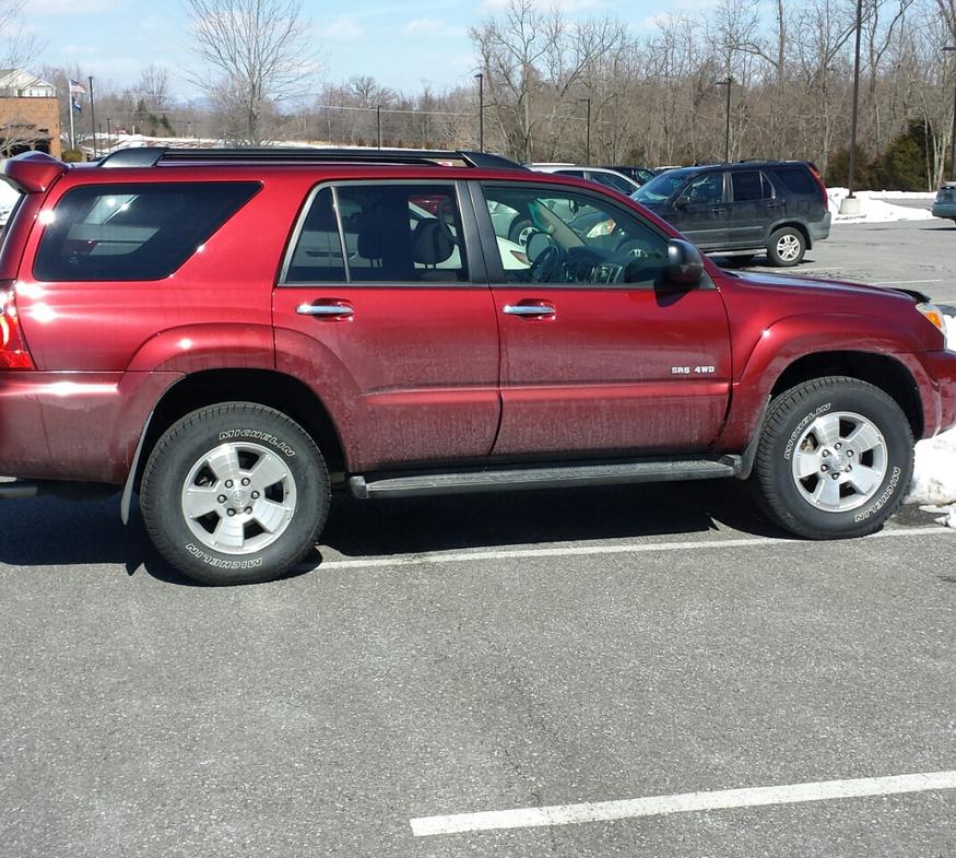

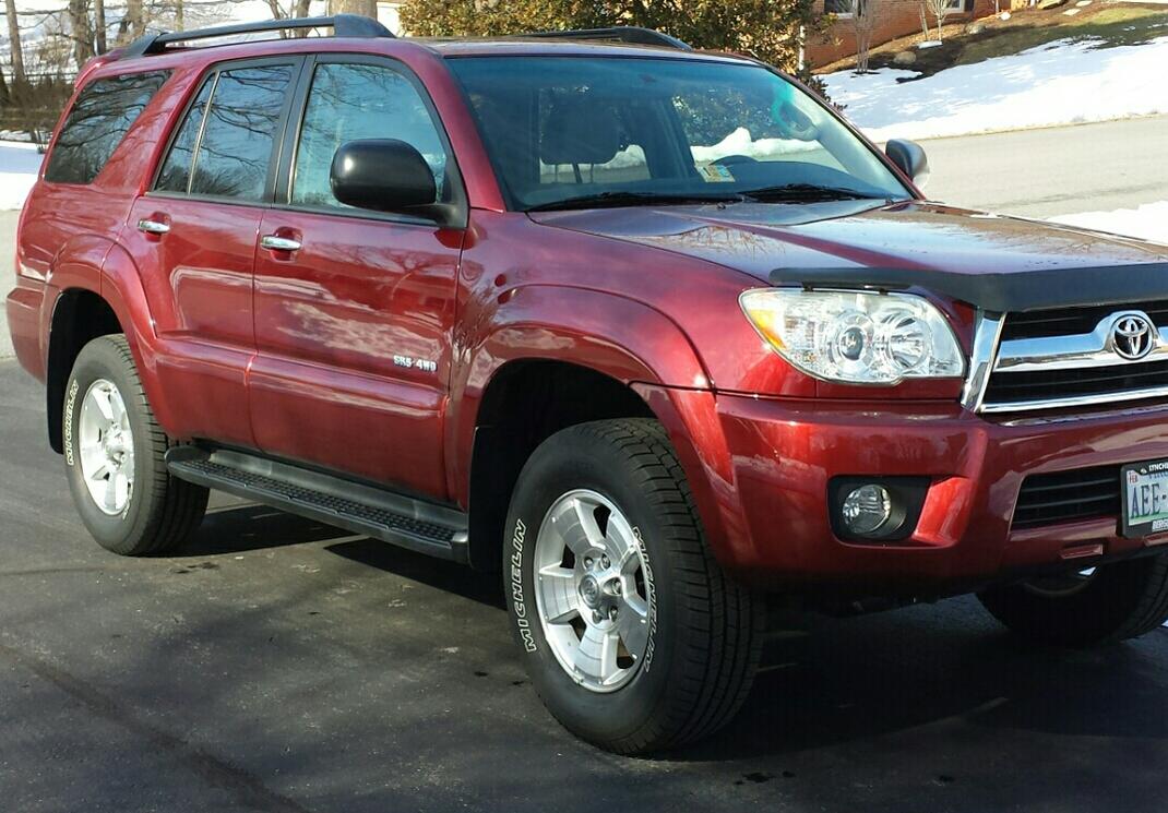

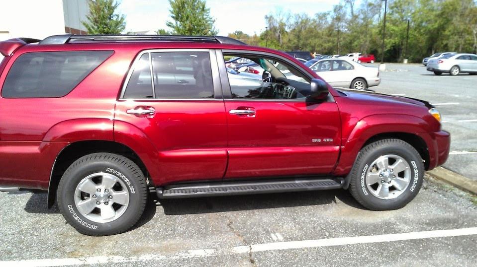

It is now the best riding car I've ridden in. I can't believe how smooth it rides. The suspension is firm, but compliant. The biggest difference is when going over speed bumps, it doesn't go thought the shock's full range of motion. Anybody on the fence about this upgrade, just do it. What we did was 5100s all around with the fronts at .85 and a set of FJ front coils. Looks completely level and mean to me. These pics are quickies and I plan to do better and add the before and after measurements in a bit.

Gosh, Yours makes that poor Runner behind ya look kinda sickly. Lol
Yep, would like to do some Cooper Ats the next size up when my M/S's wear out. Sadly, could be years. Lol
yea its a friend of mine, that picture just happened to be from cars and coffee in richmond. what part of VA are you in?
i ended up going with 255's and love the ride. really liking the look of a 32" tire
I wouldn't change anything on yours. Perfect the way it is. I'm a less is more kinda guy.

i did about the same as you did but with trd offroad tacoma coils. i also agree about how it handles speed bumps better. any plan for different tires?

Well, here's my preliminary numbers. 08 Sr5 4x4 4.0 with 5100s all around and FJ front coils only.
Before: LF 33 RF 33.5
LR 35.5 RR 36
After: LF 35 RF 35.5
LR 36. RR 36
I'm pretty stoked on how it all turned out. The passenger running board is spot on level front to back. The driver seems to be 1/8th front high with a half tank of gas. I figure 10 bucks of gas and a driver would make it perfect. Perhaps a jack might raise it up that little bit. Lol
