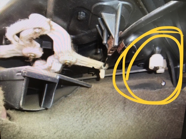

sorry to start up an old thread and hopefully you have solved the problem by now...but in case you haven't or someone else has the same problem...I have a 98 with a similar problem. There is a control arm on the bottom of the heater case that controls a blend door that is susceptible to drunk friends breaking with their feet, and when they do, you lose some control over temperature blending. The air comes out of my center vents (defrost, feet, and face) luke warm, but the air on the side vents comes out desired temp. This could be your problem, it may not. The solution is to find a new heater case and install it (might as well swap heater core while you are at it), which means taking the dash apart. I have included a picture of what it should like above the passenger footwell. Hope this helps!
I had the same problem. I found the sheath for the cable to the blend door had broken and the blend door wasn't opening. I used Gorilla tape to tape the sheath together and it is working again.
In the picture above, it is the cable just above and to the left of the yellow circle. The sheath was conveniently broken right about 6" from the rusty clip in the picture, so it was an easy repair. We'll see how long it lasts.
This actually worked for me. Simple but it worked thank you for pointing this out!
