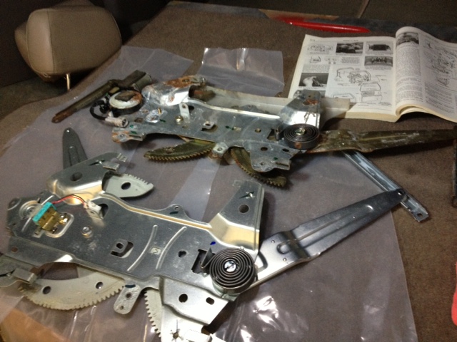

Sounds like the guide rails or the whole thing for that matter may have rusted out. Happened to me this summer.
The guide rails expanded as they rusted then it seized up.
I replaced the whole mechanism. You can see how bad the old one was.
Looks like mine! lol.
I gave mine some TLC as rolling the rear window down used to result in a god awful noise.
Had to repair one of the window brackets and clean off the guides before spraying a little lube. Works great now, but I know it's only a matter of time before I'll need to replace the whole unit as well.
