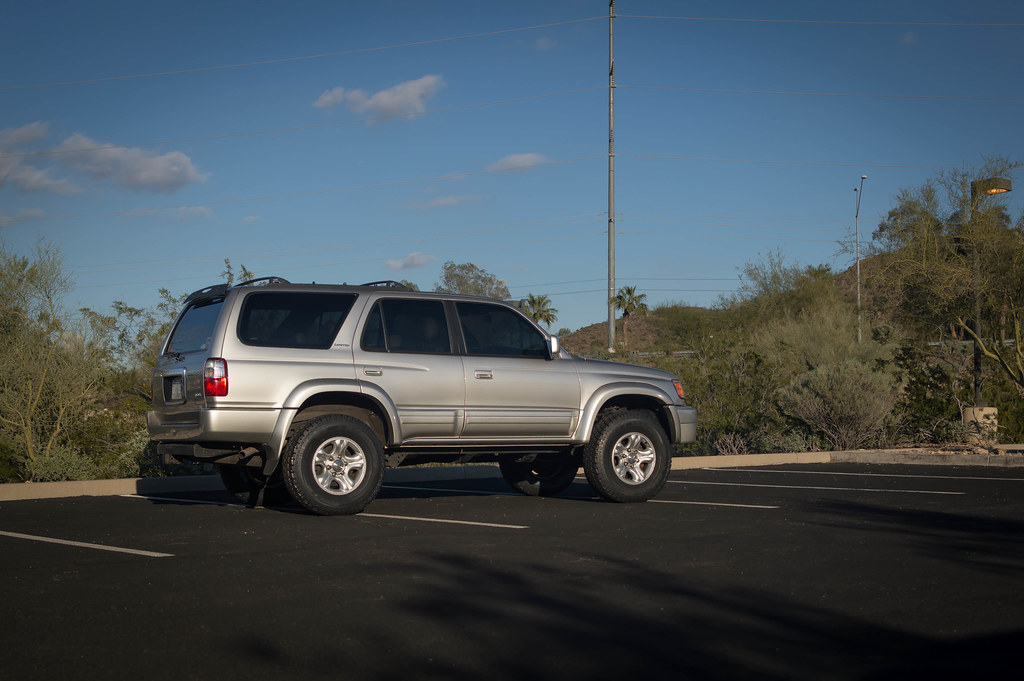

I just went through this exact same research phase. I ended up buying moog springs for front and back, and kyb gas shocks all around. It gives the 4runner a nice solid ride. It is not soft, it is what I would call more firm. However you have to realize that soft or hard is relative to a 3rd gen 4runner. You won't ever get that true soft bouncy pickup ride that takes bumps without feeling it. 3rd gens are a firm truck and are designed that way. A 4th gen and newer will give you a more plush soft ride if that is what you want. I ordered one set of each from Amazon: moog 81401 and 81088. Then on ebay I bought the kyb gas a just shock kit for $205. So that plus moogs and new sway bar bushings I got new suspension for a total of $330 doing the labor myself. Brought my ride height to perfect for me because this is my daily driver. Here is how it sits now. I hope this is helpful. Put me to probably the same height as a stock 99 or a bit higher.

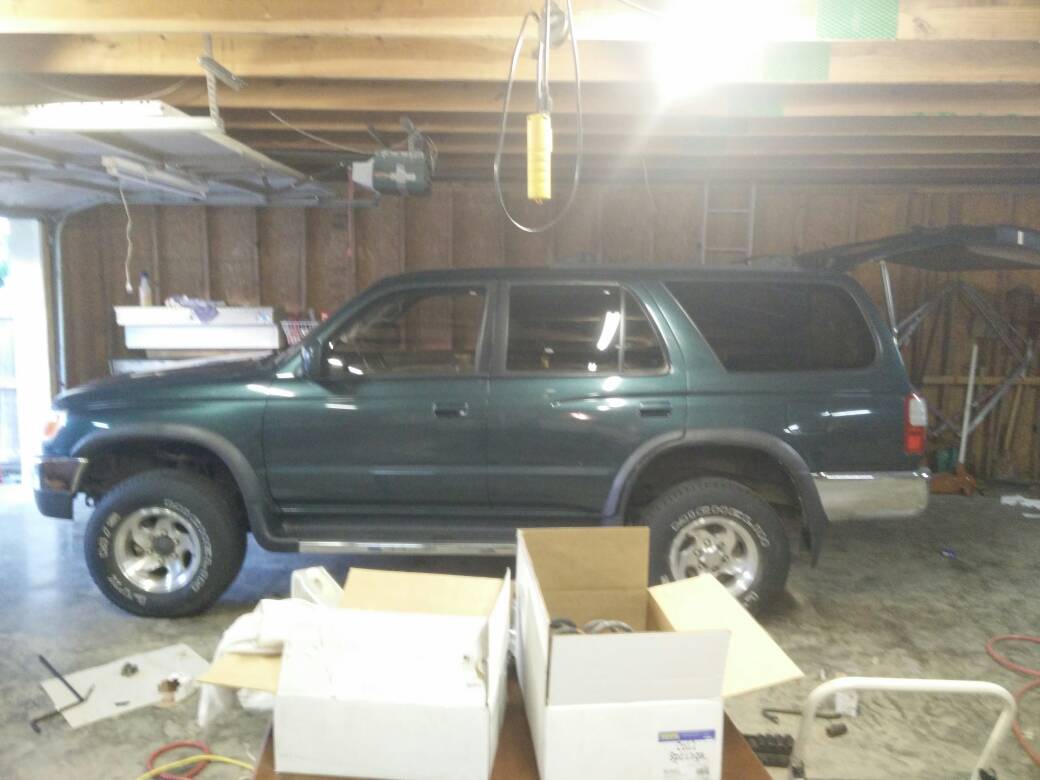

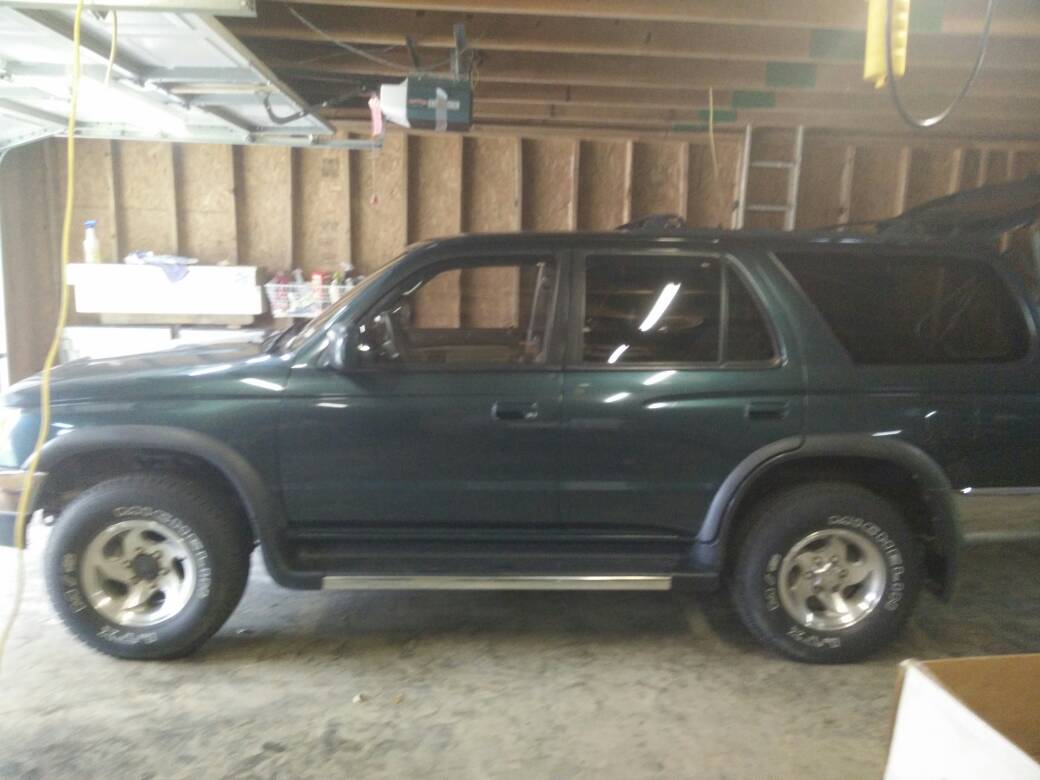

My stock suspension is shot. Replaced the back with 906 first. Gives me rake. Not bad but just put on 881 front and took them right back off lol. Passenger side ubj and drives side cv axle are really unhappy with this new arrangement and started weeping at me the first test drive. Besides that I think I'm going to 890 and put the 881s back on to loose the reverse rake. It looks horrible like that to me.
