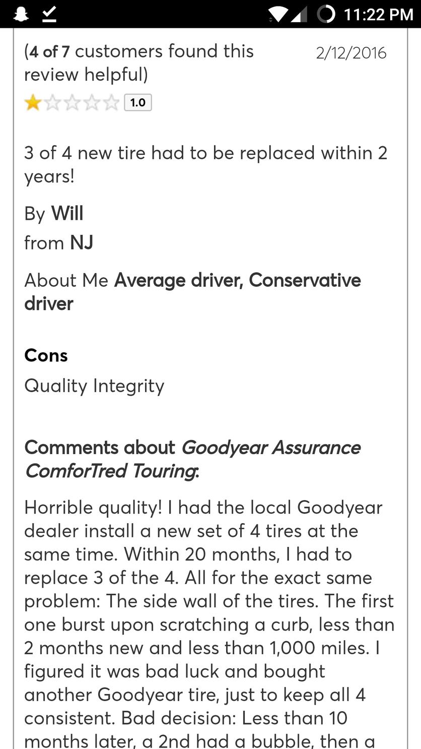

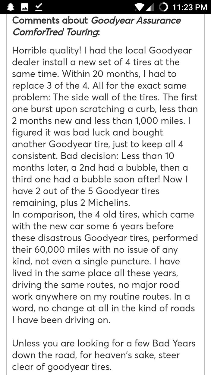

Seems like I'm not the only one who had this problem
