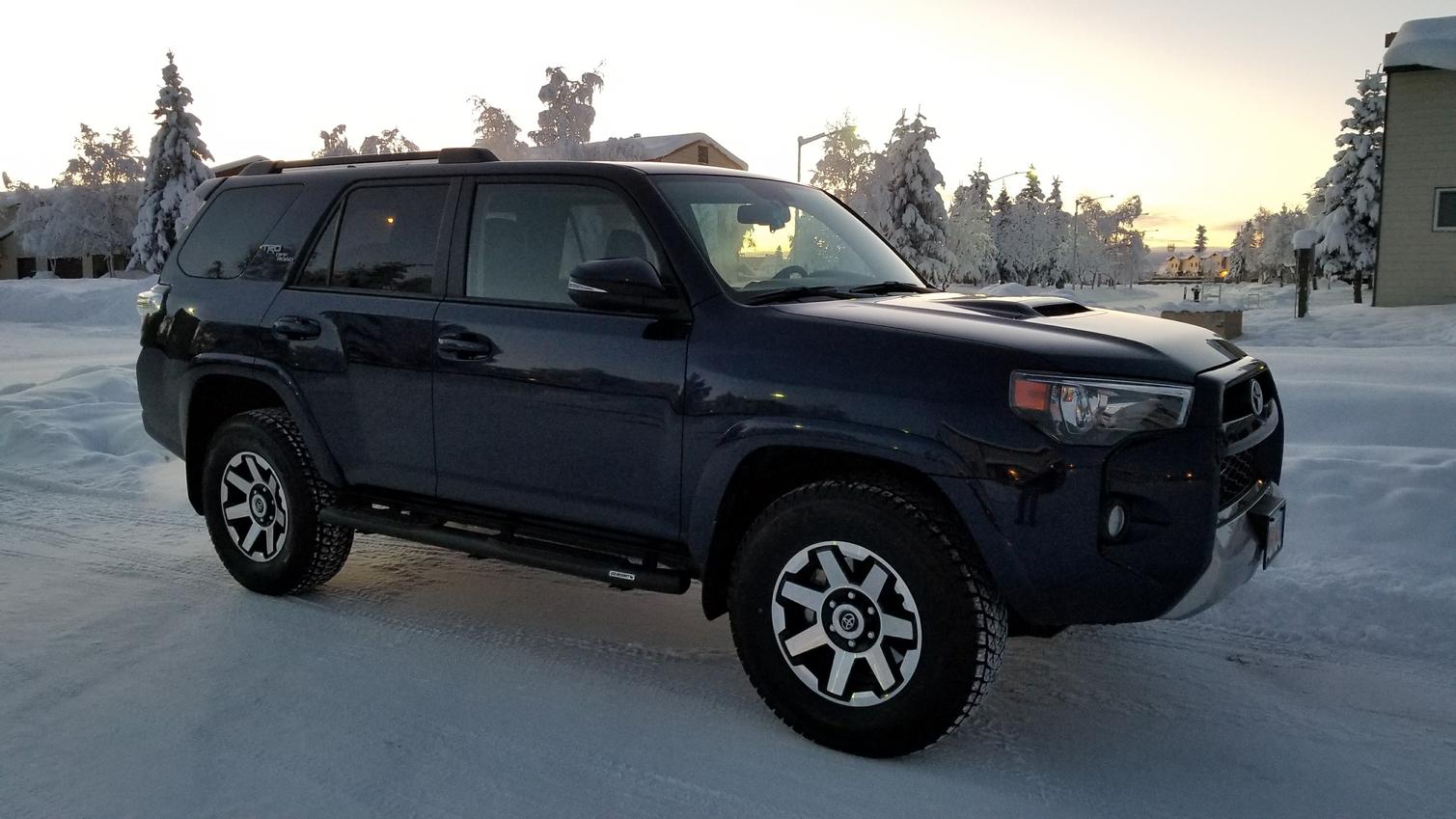

I've got a '17 TRD OR Prem that I plan on towing a 5K lb camper (once fully loaded) around Alaska this next summer. I also plan on doing some off roading... I mean... it is Alaska.... However, I'm more concerned about the towing aspect. Do I NEED E-rated tires (or load index 118+) to tow a 5K lb camper with my rig? Would some 115 load index tires cut it? I plan on sticking to stock size BTW. What has been your experience?
p.s. I sold the Dunlop OEMs because they are complete garbage. I'm running Blizzaks for winter right now.
