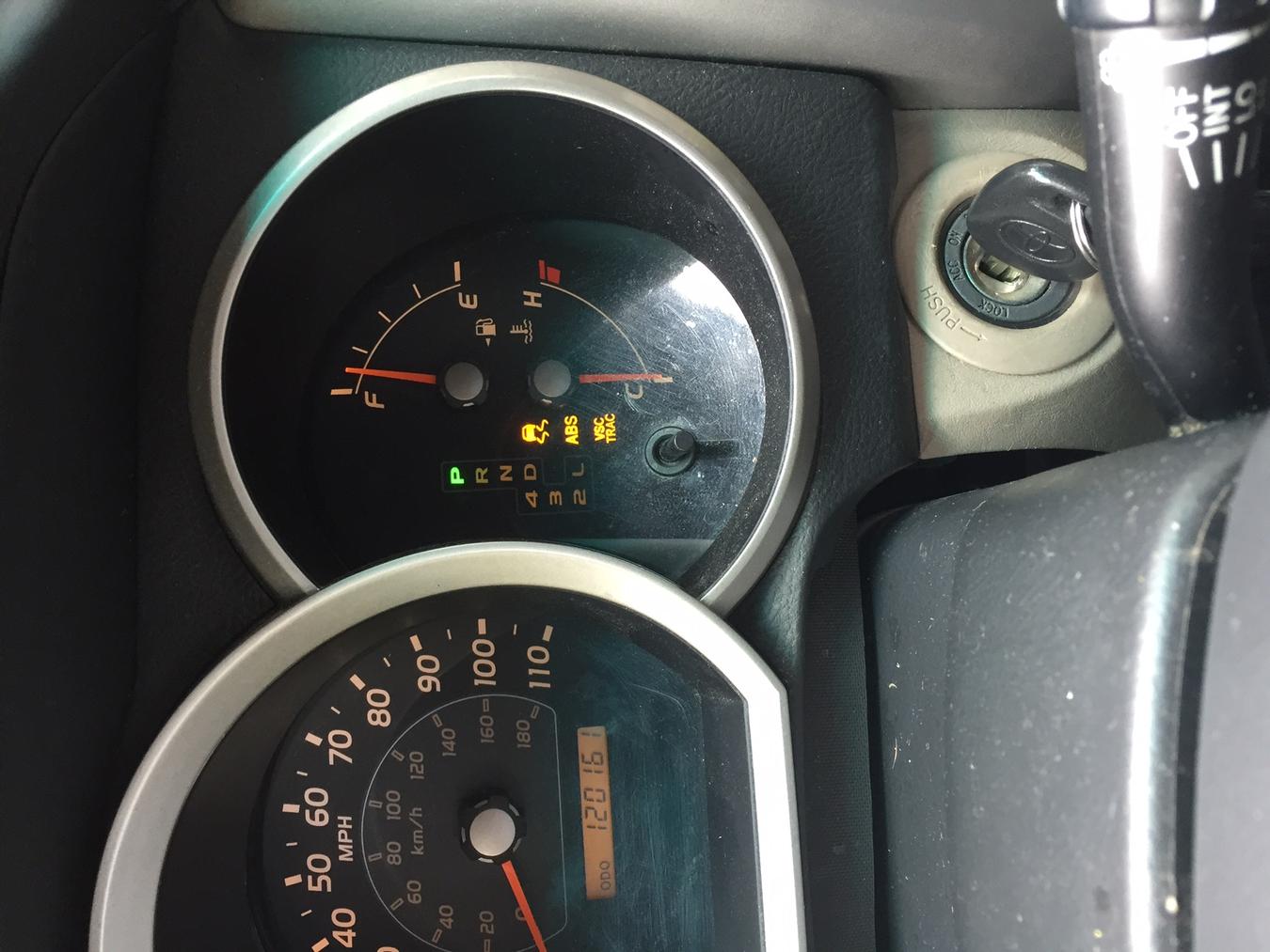

I've read several posts about this issue but haven't decided what to do to fix it. My 07 SR5 is showing the warnings in the attached photo. I recently bought new tires, and the shop tech confirmed that I needed new rear ABS sensors ($200-300). I've seen sensors online for anywhere from $50 to $150 a piece. I'm trying to decide whether to buy the parts and attempt to do it myself, or just bring it to a professional. What is the difficulty level for this repair? Could I do it in my driveway with a small jack? Does anyone have a suggestion for an online parts supplier?
I'm leaning towards paying a professional, if only for the safety of having a warranty should something else get broken during the repair, but I'm not convinced my tire shop would be qualified to do it. Is this something I should be concerned about, or is it a pretty standard task? Can anyone recommend a reputable mechanic in the New Orleans area with experience doing this type of repair?

First of all mechanics lie. I'd pull the codes and see what's causing the lights to come on and then go from there. Look up the codes on this site to study up on the fix.

Yep. Pulled the codes: c1223 & c 1249. I saw on this same thread that it may be the brake light switch. Will try to replace today
Yep, that was it. No more Christmas tree on the dash. On to the next issue: disconnect TPMS light.
