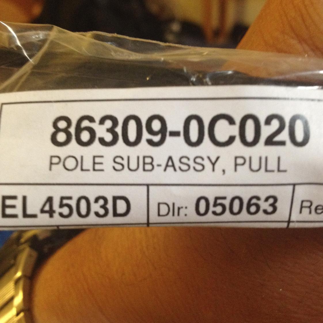

Parts:#86309-0C020 Antenna Pole assembly(32" mast with wire wrapped and covered in black. Flexible but not like a real WHIP mast.
Dealer List Price: $55.03 my price: $30.00

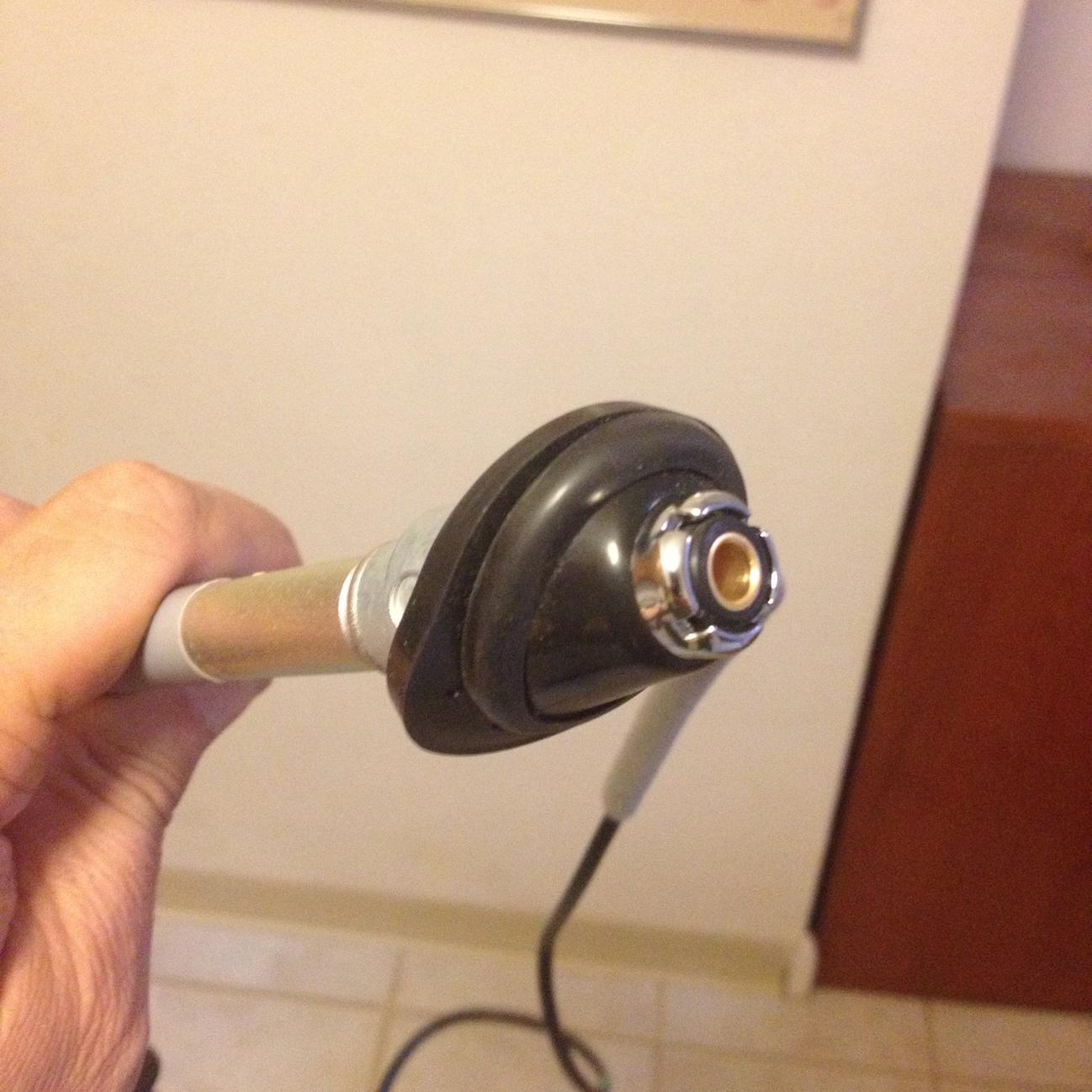

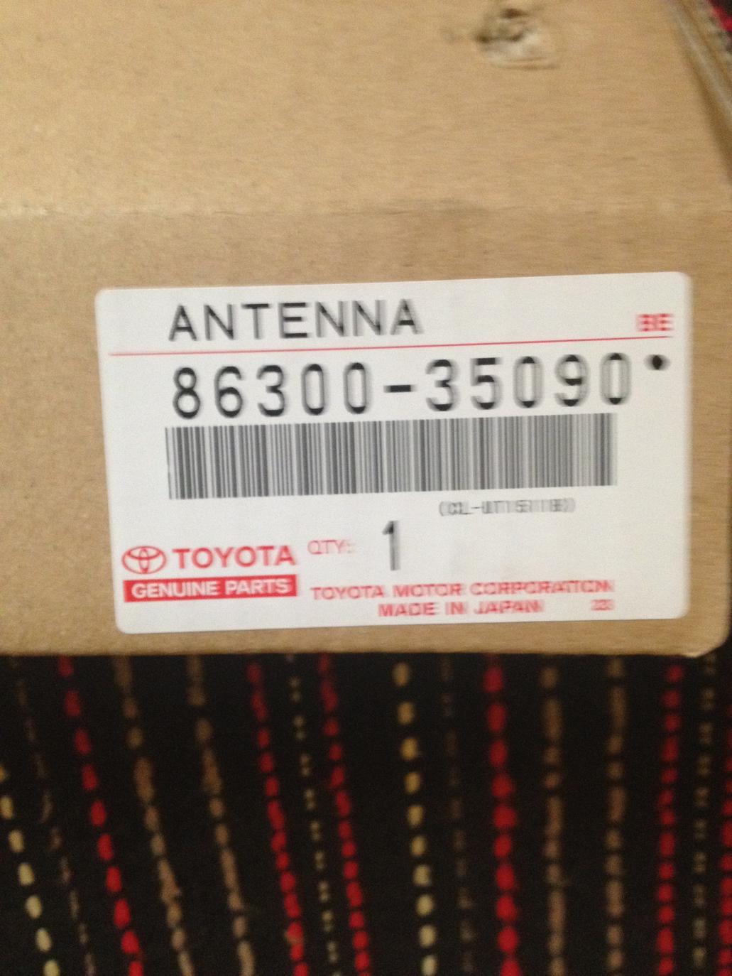

Part: #86300-35090 Antenna Assembly(non-powered)incl:decorative cover collar and locking ring nut.
Dealer List Price: $99.58 my Price: $51.00

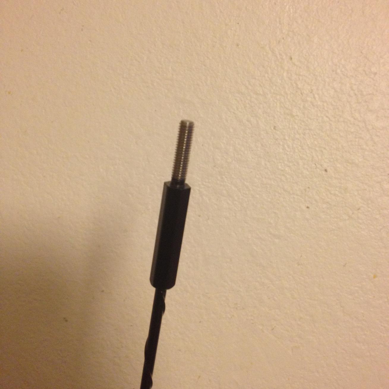

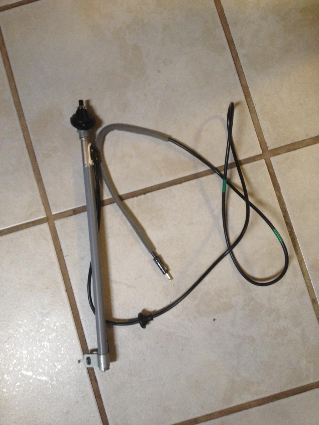

here are some pics of the 2 parts I got from TOYOTA.
