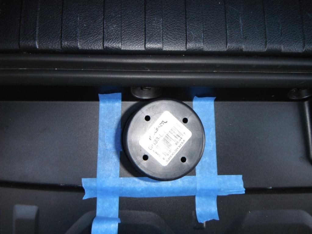

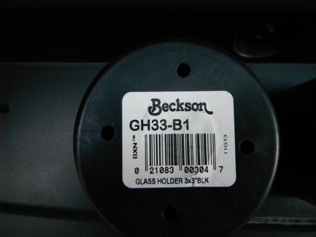

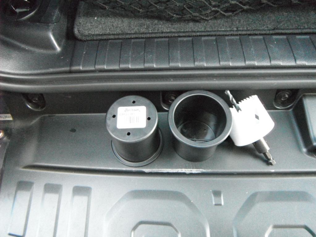

Here are the parts/tools you need. 2 cupholders, and a 2&1/2" holesaw
Closeup of the back of the cupholder

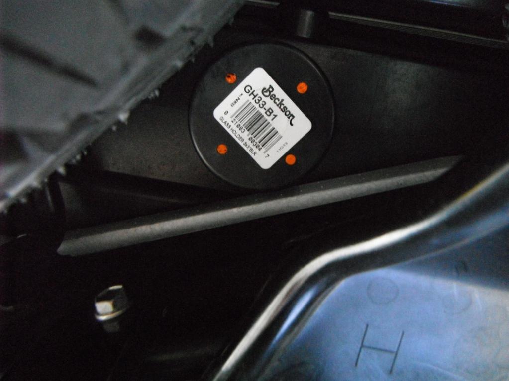

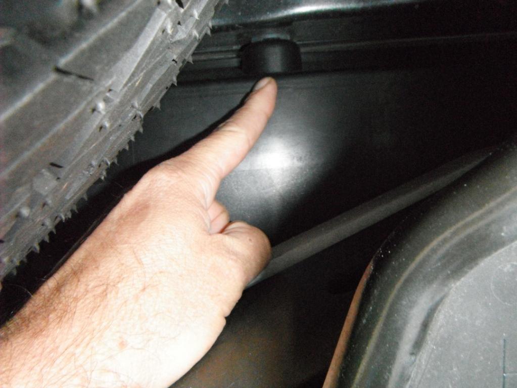

This is the space you have underneath the bumper- even more room on the passenger side! I'm pointing to the bolt hole you can see in the other shots.

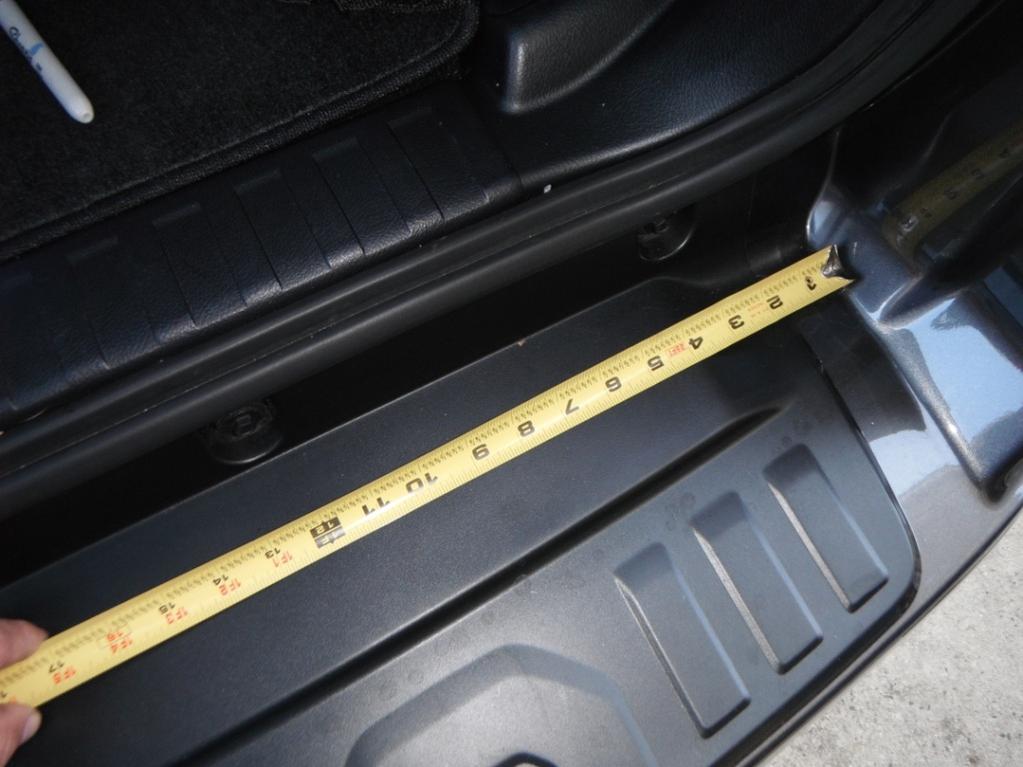

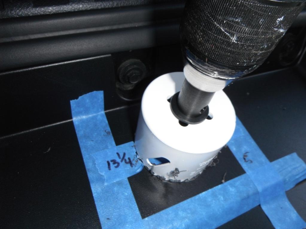

The measurements for the center of the holes are, 1&3/4" from the front edge (where the screws are holding the bumper on), and 13&1/4" from the edge of the door opening. (Not sure if the measurements will be the same on a TE) More pics of the measurements on the pass side...
Time to drill. YAY!

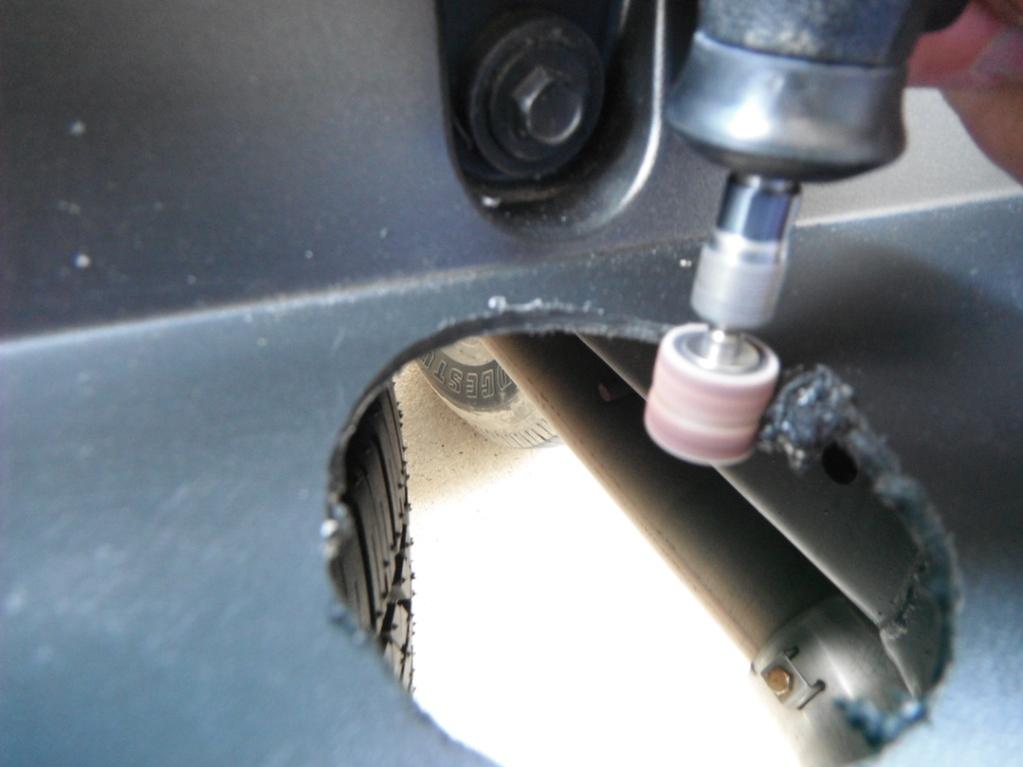

Dremel the hole to the correct size. Grind a little and check. Be patient. When it's a little too small, push the cupholder in forcefully until it's fully seated. Be sure you trim the edges where you ground the hole so the cupholder sits nice and flush. Hey, check out my CRAPPY TIRES!

This is the edge you measure from for the hole (same on both sides)
Look how much room there is! And you thought you were going to drill into the spare tire didn't ya? Admit it...

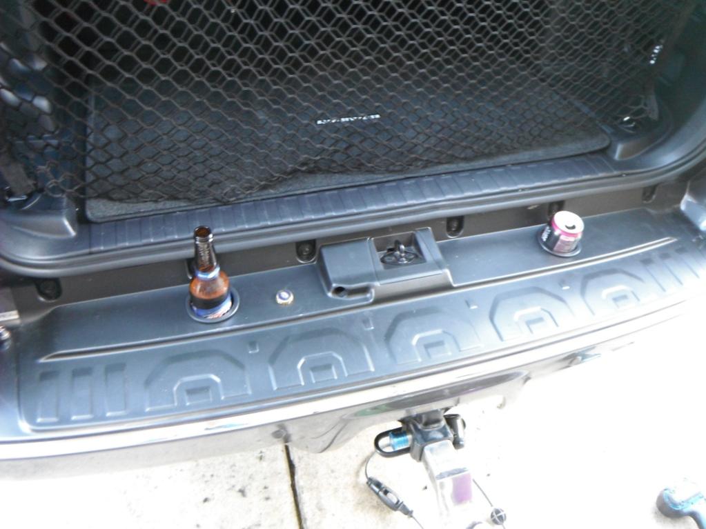

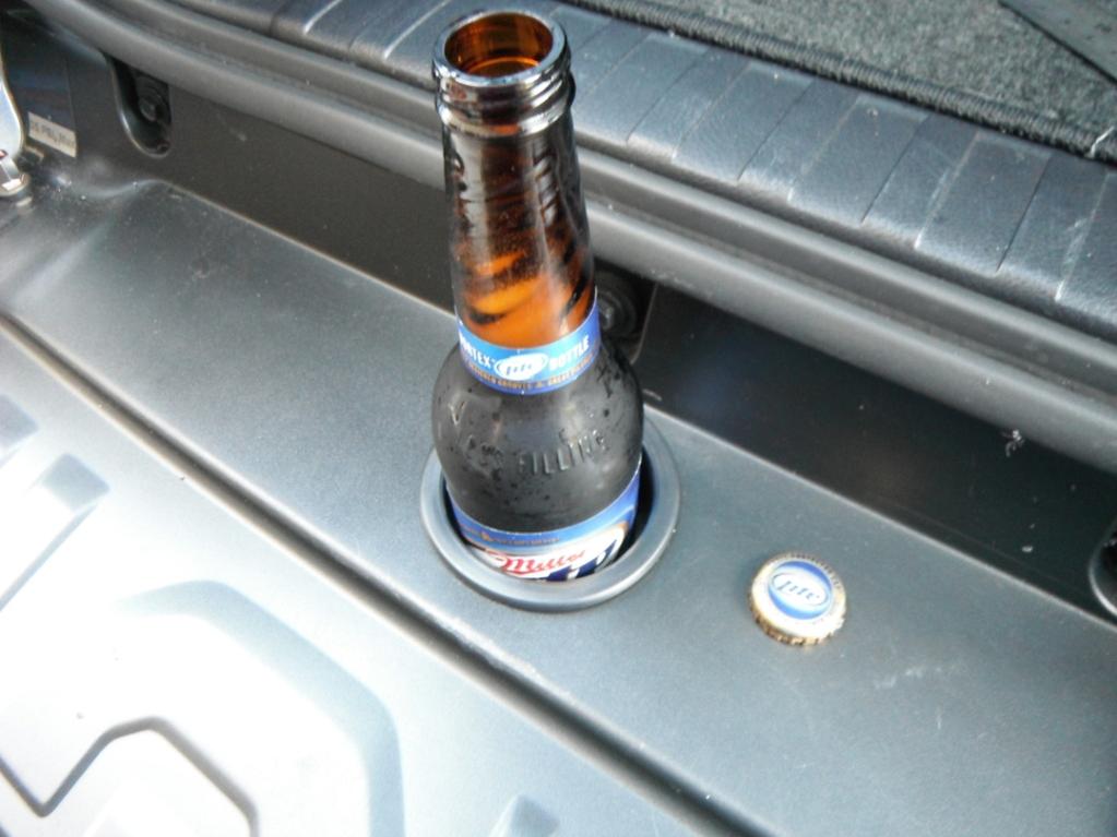

All done!
No, they don't contact the hatch (even with my ladder)
No, you can't see the cupholders with the hatch closed
No, water can't get into your truck
YES- If you try to close the hatch with a beer bottle in there, you will make a terrible mess. Better not drive home if that's the case... :)
