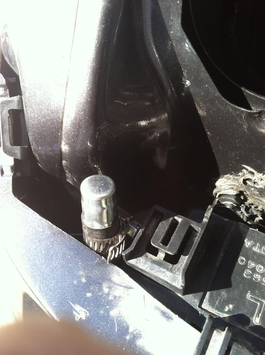

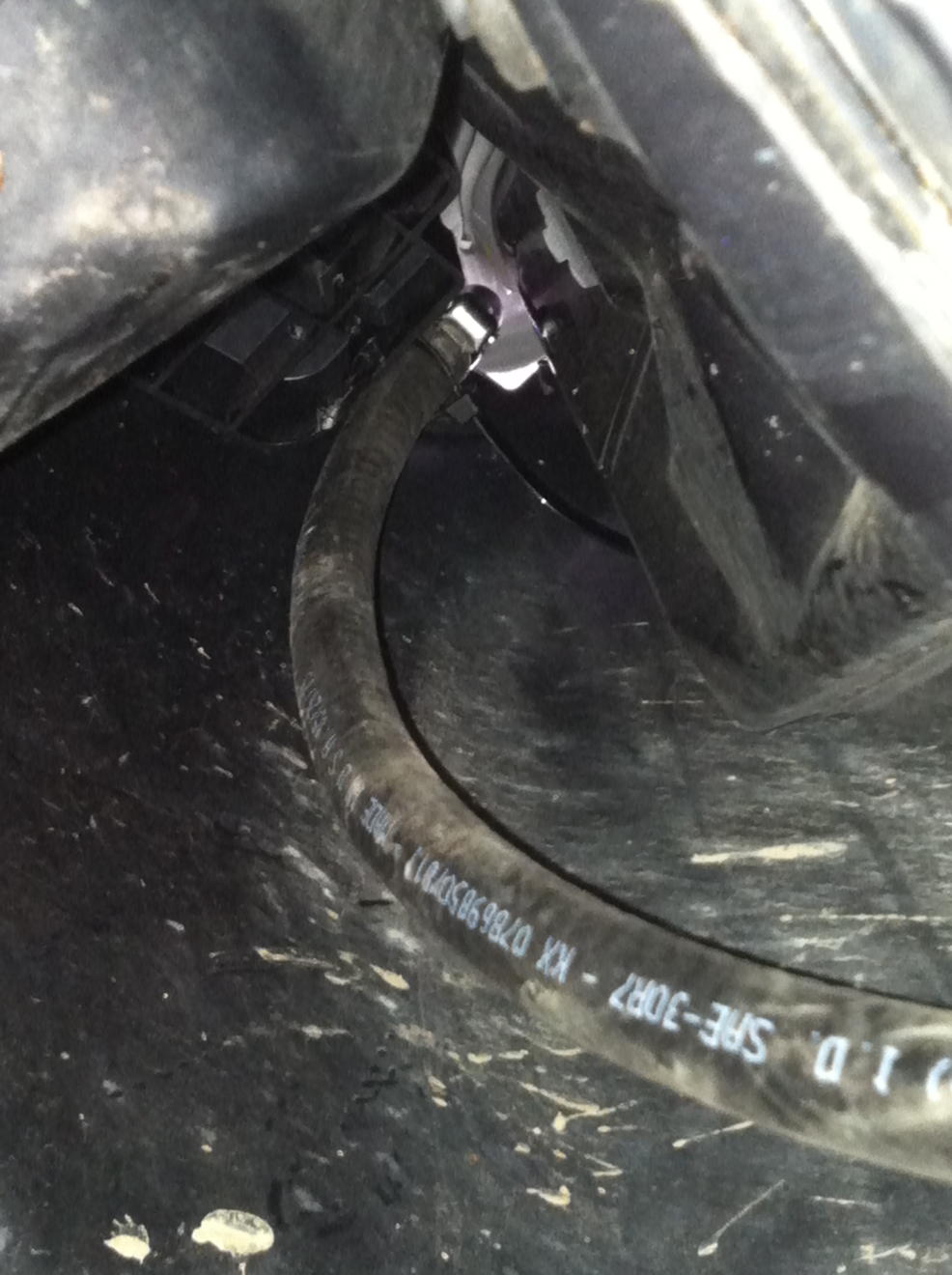

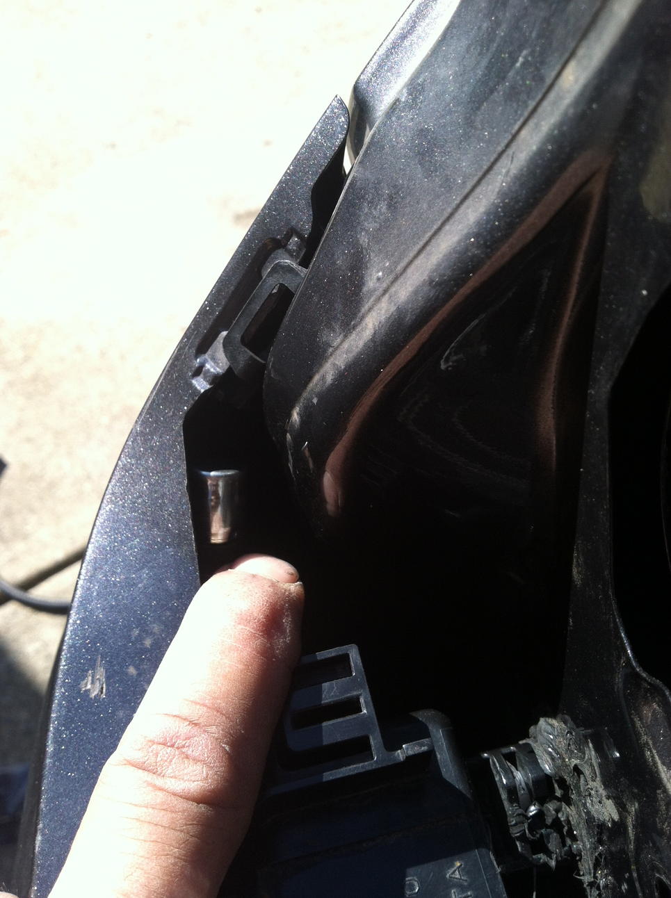

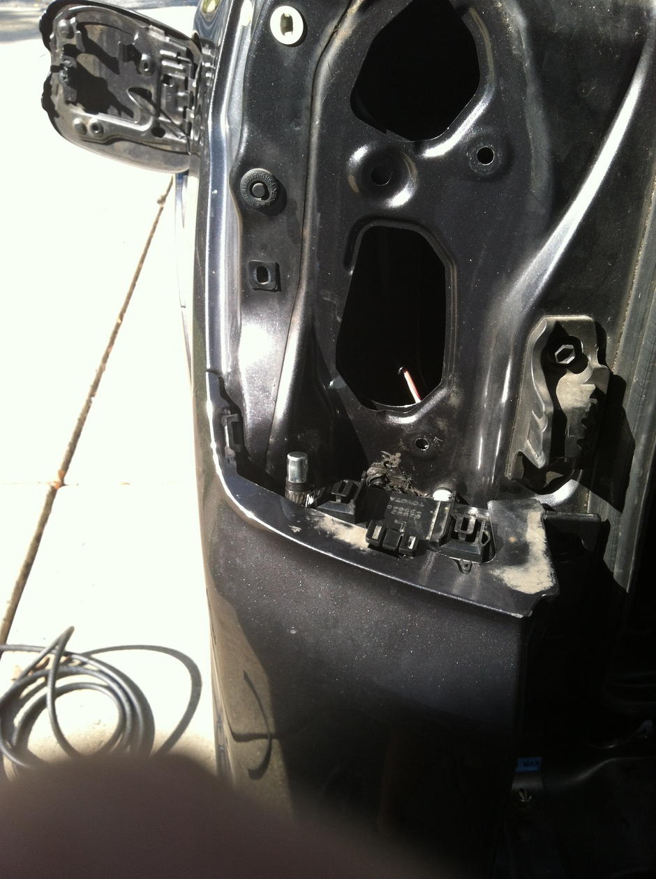

Relocated the rear diff breather to the taillight area- no holes to drill that way, no routing into the truck, and super easy!
It tucks out of the way nicely- I zip-tied the hose to the black plastic bumper support to keep it in place.
Here's a shot from underneath with the taillight installed.

I need to do mine still. Let me know what your weekdays/weekends look like. I like this option a lot better than the gas tank rubber. Good thinking!
