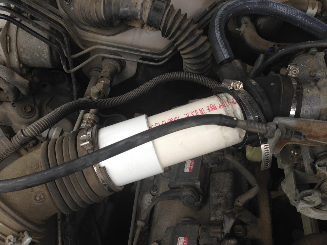

My intake duct (3.4L, the small one from the manifold to the box) has a huge crack in it. I've tried searching around for a used one in junk yards and even online, no luck...
Anyone used anything else before to replace it? I'm thinking a proper diameter hose from Lowes or Home Depot to be honest. It's only like a 6 inch long tube with a clamp on each side. I'm NOT paying $80 for a little piece of rubber on an old truck that I drive 4000-5000 miles a year.

tried that...nothing in the right size. jumps from 2 inch to 3 inch. 2 inches is way too small, 3 inches is way too big. been at this for days now.
I patched mine temporarily with JB Quikweld (just to get around) and purchased mine for 42$ at the dealer. Same piece.

yep. ripped off the part of the boot that normally connects to the TB, turned it around, then jammed a 2" PVC pipe into it with a coupler on the other end so that the duct from the box can clamp down tight onto it. seems to seal quite well and I was able to keep the little port for the emissions stuff. it's basically a modified version of the ISR mod.
going to pull it off tomorrow and wrap it in carbon fiber vinyl (since I have some laying around) to make it look decent. once I can find a replacement boot I'm going to go to a muffler shop and do the ISR mod properly.
