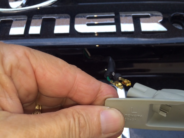

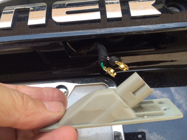

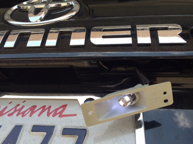

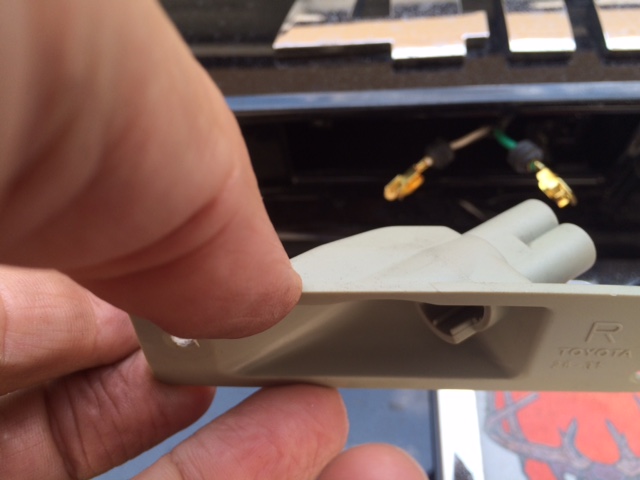

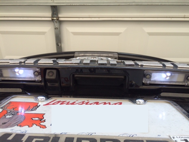

You inspired me to see if there was another solution other than what [MENTION=88975]Swarty[/MENTION] posted or cutting and lengthening wires!
I think Toyota must have made the harnesses just a bit short. I don't think they wanted to redo the harnesses or to go thru the trouble of installing the lights right in right & left in left orientation.
So they put them in as we find them!
So this is what I found...
I removed both fixtures, removed the electrical connections from the fixtures, swapped the fixtures to the "correct" side R=Right, L=Left.
(Keep them oriented correctly because the mounting holes are not centerd on the fixture!)
I had to pull the harness on the right side to have enough slack to remove the connectors from the fixture and to facilitate putting the fixture back into its place and bolt it up!
Hope this helps

[MENTION=103267]Saker[/MENTION] So you didn't need to cut or splice any wiring?
By the way, the Owners Manual (p. 396) shows the bulbs facing outwards as they are installed at the factory.
Perhaps Toyota switched them at some point to reduce glare from the license plate in the backup camera, although it seems unlikely that would cause a problem.
Didn't cut or spice.
Just checked with the garage door down....didn't appear to.
Will see at night under normal conditions...
