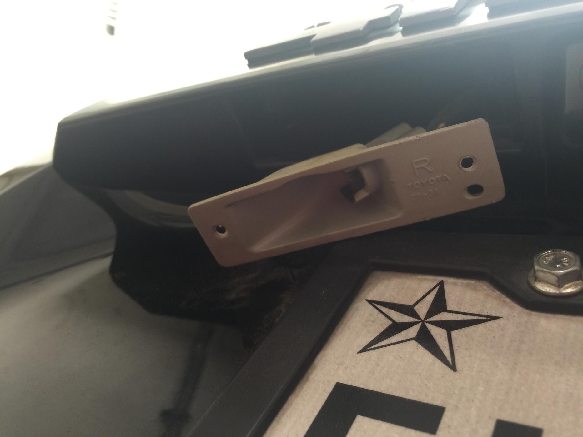

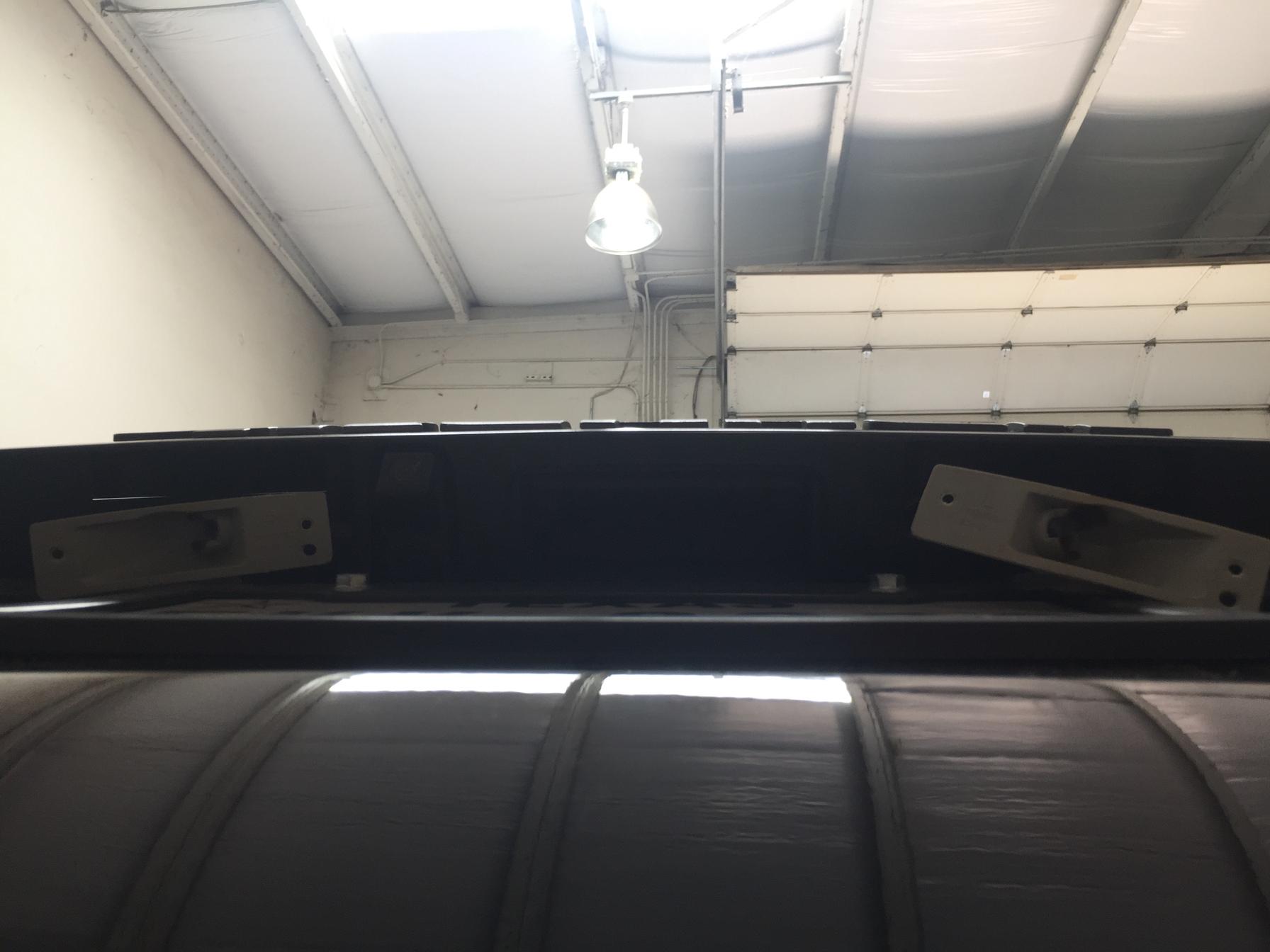

I just reversed my license plate housings, so now left is on the left side
And right on the correct side also.

I had to cut the wires close to the housing and solder a 6 inch wire extension on both side since there was not much length to play with in order to fit while reversed.

Yes they were , bulbs were oriented towards the tail lights instead of towards the license plate....maybe the idea is to be able to provide a wider beam so that a European type license plate is fully illuminated?
I had to change a bulb today, and noticed mine, too, were reversed.

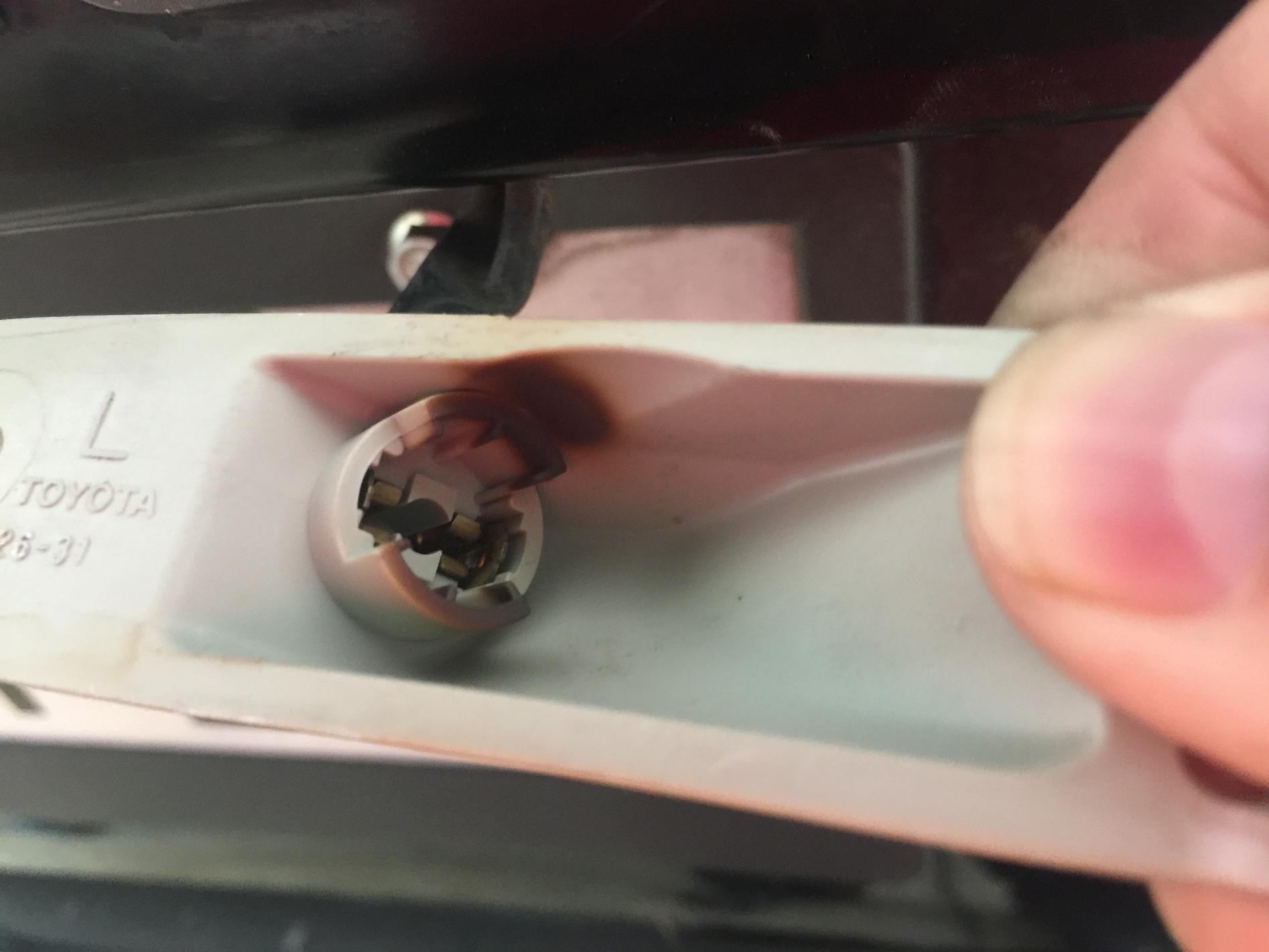

Also, notice there is considerable char on the top side of the housings...
likely due to me running my lights 24/7...
Thinking I may affix some foil tape to the charred areas...
