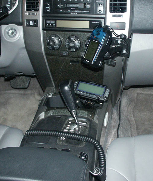

Some pics...here's the front console area. I'm thinking once my nav system is installed, I can use my mount for the gps for the radio (which is down low and hard to reach right now). I'd have to find another location for the existing gps, unless anyone has found if the solara/camry nav systems will output NMEA gps data via a serial port...I doubt it, but...

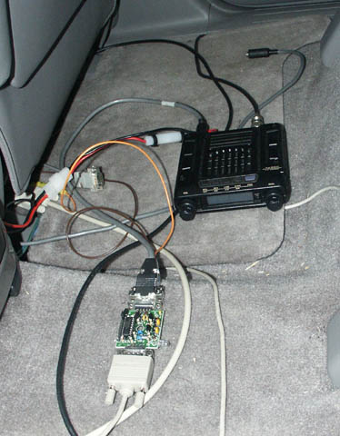

and here's the opentracker and ft1500 on the back floor boards. I really need to move this. I'm thinking of mounting this radio in the center console as it doesn't generate a lot of heat in normal use.

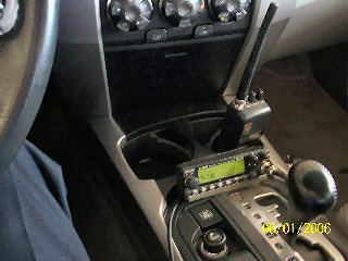

Here's a pic of how my rig is mounted. The radio is mounted on the fender well hump in the back and the face plate extension cable runs under the carpet and comes out under the driver's seat and up the side of the center console.
The face plate sits on a piece of high density foam which is stuck with double-sided tape. Another piece of double-sided tape holds a flat piece of plastic on which is velcro. The other half of the velcro is on the back of the face plate.
The mic holder is on the side of the console in the passenger's leg area - the top of it's just visible.
The only hole was for the antenna in the roof. I mounted a dual-band Diamond antenna that looks like the older cell phone antennas. And it fits in the garage with nothing hitting.
