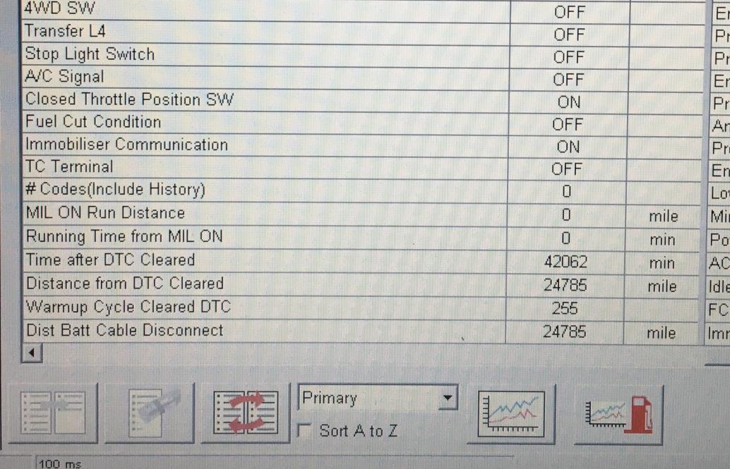

One thing that I did notice after a battery disconnect is that some of the emission test results show up as not completed. You have to drive a while to hit the correct profile for them to register again.
Disconnecting the battery will reset some DTC (diagnostic trouble codes). It will also reset your hour meter and DTC odo if you’re tracking that with TechStream for some reason.
