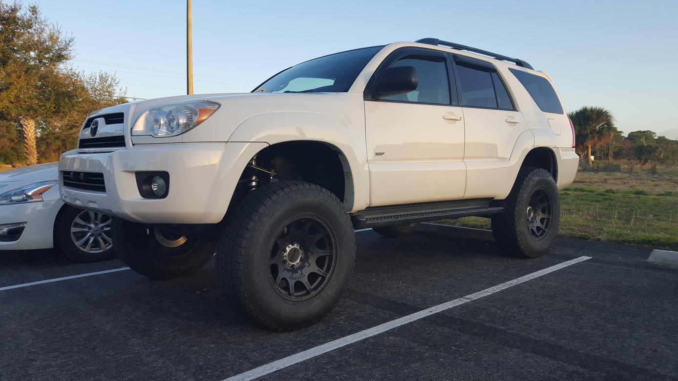

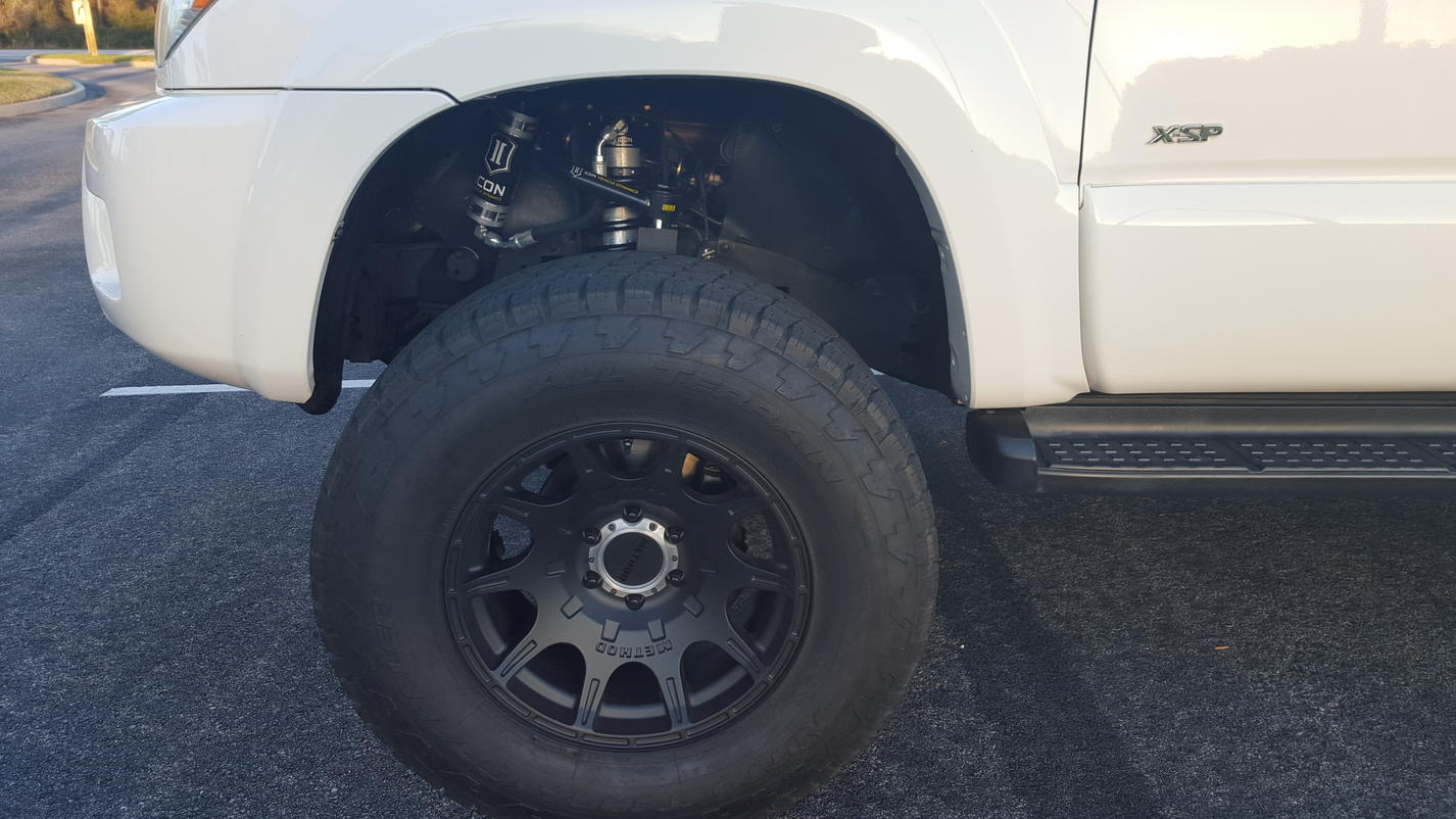

I wouldn't say mine is a full blown "pre-runner" but more inspired by them. Being only midtravel i kinda went for the clean, daily driver/sleeper look. but don't get me wrong, it handles much better than a bone stock runner would in the go-fast bits

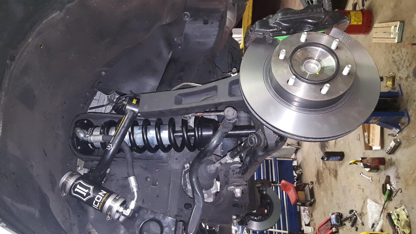

Front
Maxtrac Spindles
Icon 2.5 Reservoirs (factory ride height)
Icon UCA's
SS Brake Lines

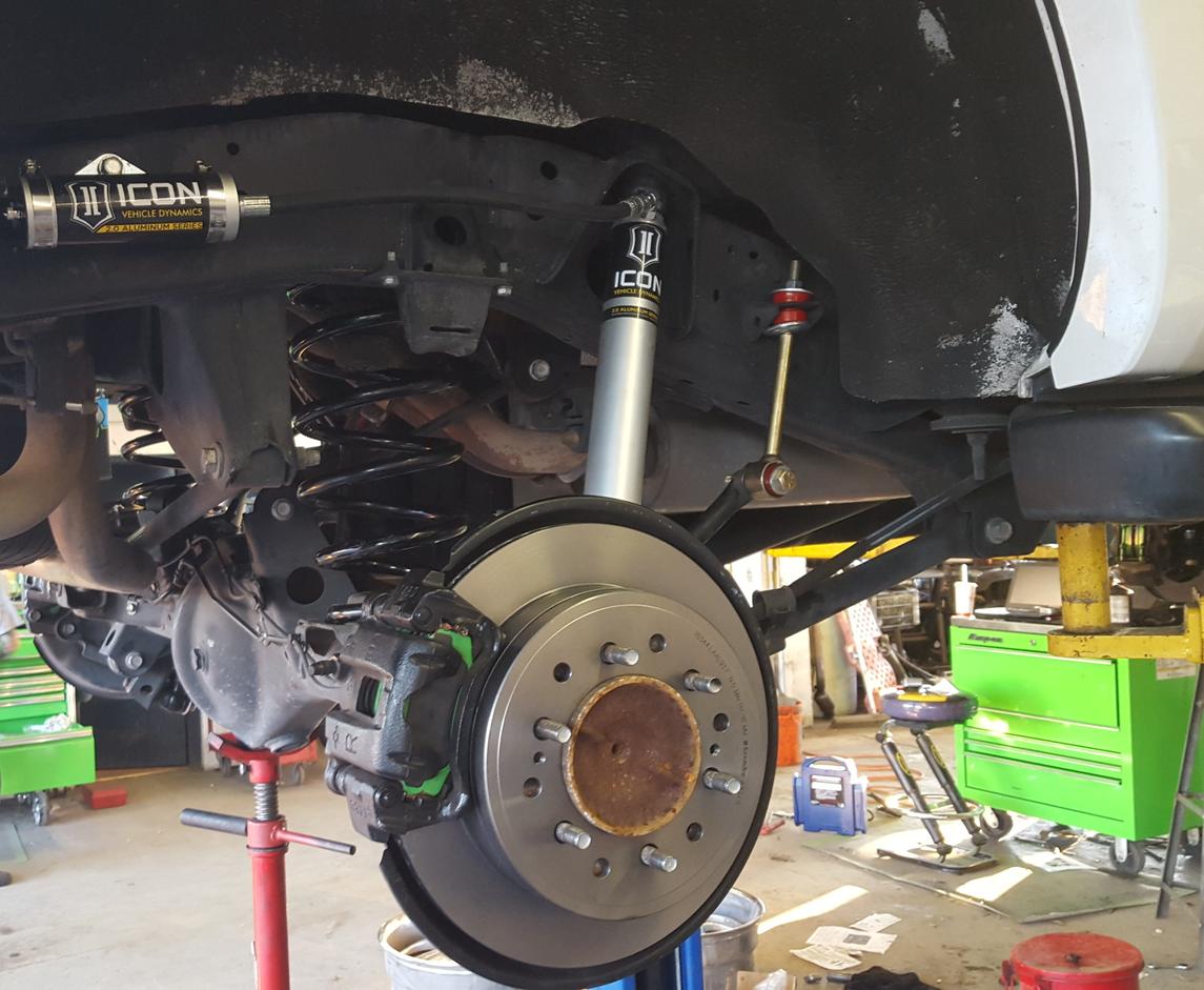

Rear
Icon 2.0 Reservoirs (custom length)
Icon 3" Overland Springs
SS Brake Lines
Extended Swaybar End Links
295/70R18 Nittos. Some trimming required at the front bumper but I could have probably tweaked the coilovers to gain the extra 1" or so to clear but wasn't willing to do that. Caster is pushed forward quite a bit so no body mount clearance issues.
I had no reason to go full long travel here in FL but I probably would have if I lived in CA. As for the ride. Way better than stock on the road. Handles most everything FL can throw at it offroad. As you know we lack the hardcore prerunning areas like CA but some decent trails can be had.

Thanks for all of yalls inputs. BHarv, your build is sick. Did you need the extended brake lines or is that because you didn't want to worry when you flex or droop?
I would go ahead and get the extended lines if you are going with anywhere over 3"+ like I was. If you go with Maxtrac spindles they come with the front extended SS lines. I went with this brake like kit from Slee Offroad (P/N STF1017). For $140 it's worth it.
Slee - Drivetrain - Brake Parts
I appreciate the advice. I'm sticking with the lift from the coilover for now and maybe running spindles in the future so I would be getting the brake lines then.

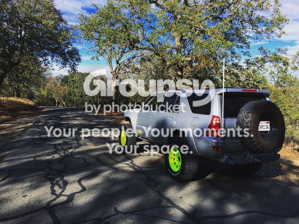

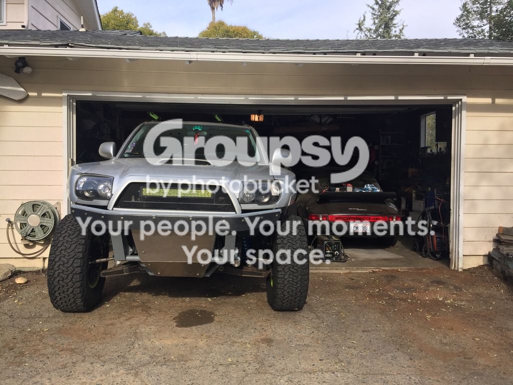

Lots of Bay Area members! Here is my truck. Probably a bit heavy to be considered a true prerunner, but I am running a Total Chaos +2" kit in the front, with 2.5" Kings in the Rear. Waiting on custom CSS real coils to counter the weight of the rear bumper, and probably going to do air bumps in the rear as well.
