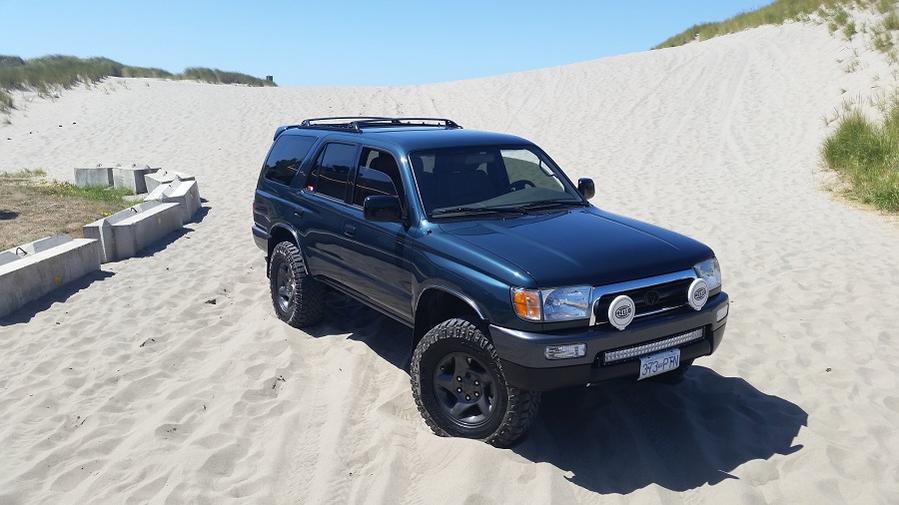

My truck is a Factory 3RZ 4cyl, 5speed Manual, and Elocker, also factory A/C and power, SR5 seats.. etc.. My truck was basically an SR5 -Leather, Wood, and Sunroof. they do exist but are very rare. So if you are die hard for the 4cyl, i would wait and keep looking for a better equipped one.
The 3rz is a great engine, mine has over 330k Km's and dosent burn a single drop of oil, much easier to work on thanks to the extra engine space and dosent require timing belt's as it runs on a chain.
My personal choice in a older toyota would only be the 4cyl engine and manual Transmission.
