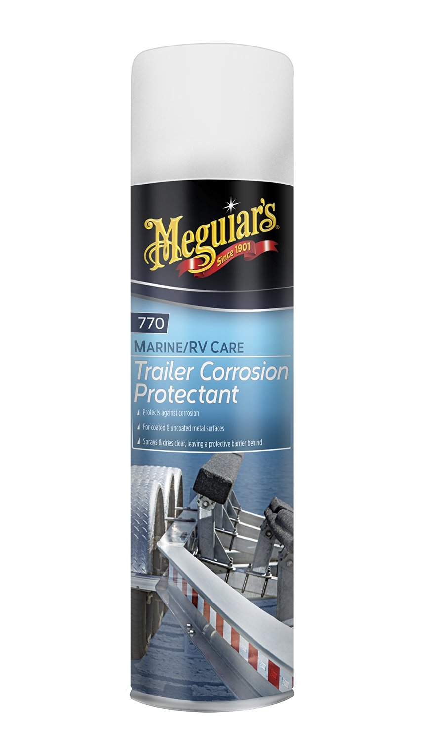

3. Whats a good spray on rust protector. Should I go all out and do the inside frame and use POR or am I ok using something like this VVVV

Fluid film. Spray or brush it on semiannually. Start while it's new and it'll look new forever.
Fluid film is not hazmat so no environmental concerns. kinda smells funky for a few hours after application but that's it and don't mistake it for peanut butter if you rejar it into smaller workable mason jars for crawling around under the vehicle.
they sell a wand for internal frame coating which works like a champ too.
