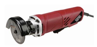

Can you buy one of these from Harbor Freight for $25 and hold onto it while it cuts the end of your body mount?
Yes. But I thought that some welding was required to "do it right"?
