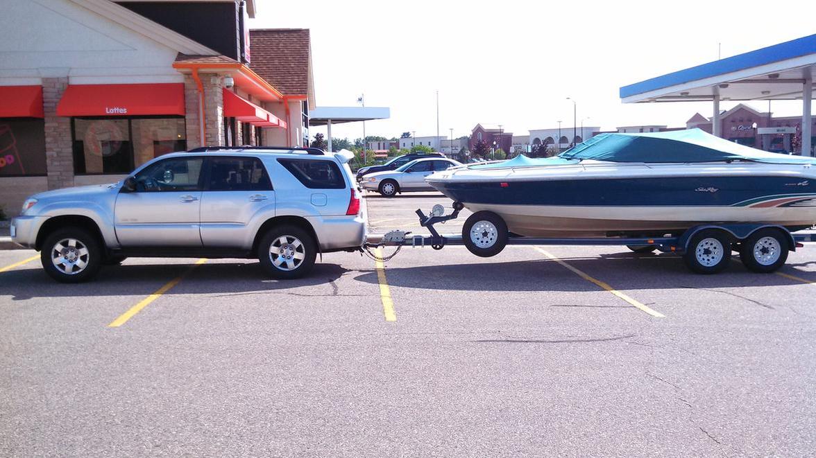

I have 21 SeaRay that with trailer, gas and goodies is about 4,500lbs. The trailer is tandem with surge brakes. I tow with a V8 2008 4Runner with no problem. The V8 has plenty of torque to handle passing, uphill, etc. However, I used to tow the same boat with my old 1999 3rd gen V6 4runner. The weight definitely slowed me down. I had to shift down even if it was a little bit of an up incline in the highway. It was horrible and annoying for long towing distances. It was fine for short distances though.
I recommend a trailer with some type of brakes. Before my current boat/trailer, the previous one was 3,500lbs but with no brakes. With that setup the braking was pretty poor on the 3rd gen.
