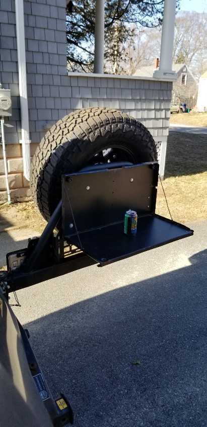

Any pictures of this fold down table?

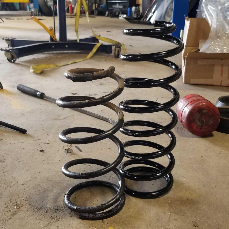

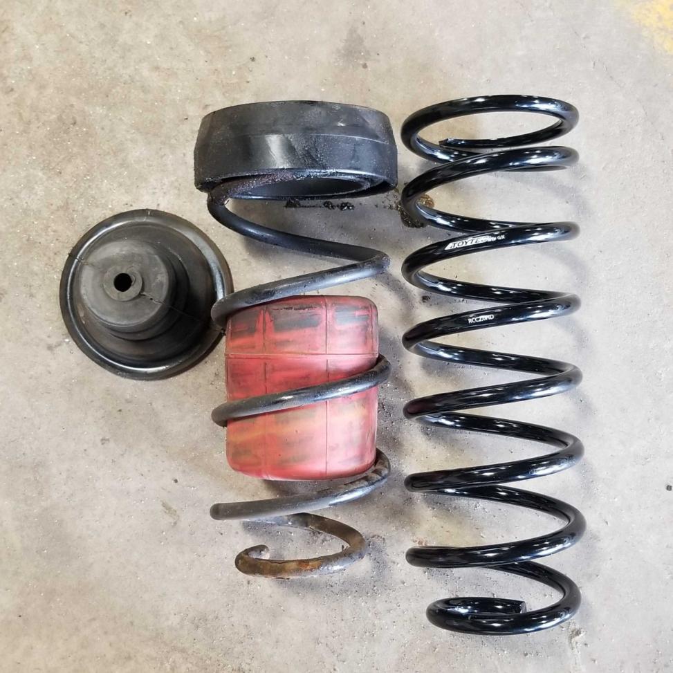

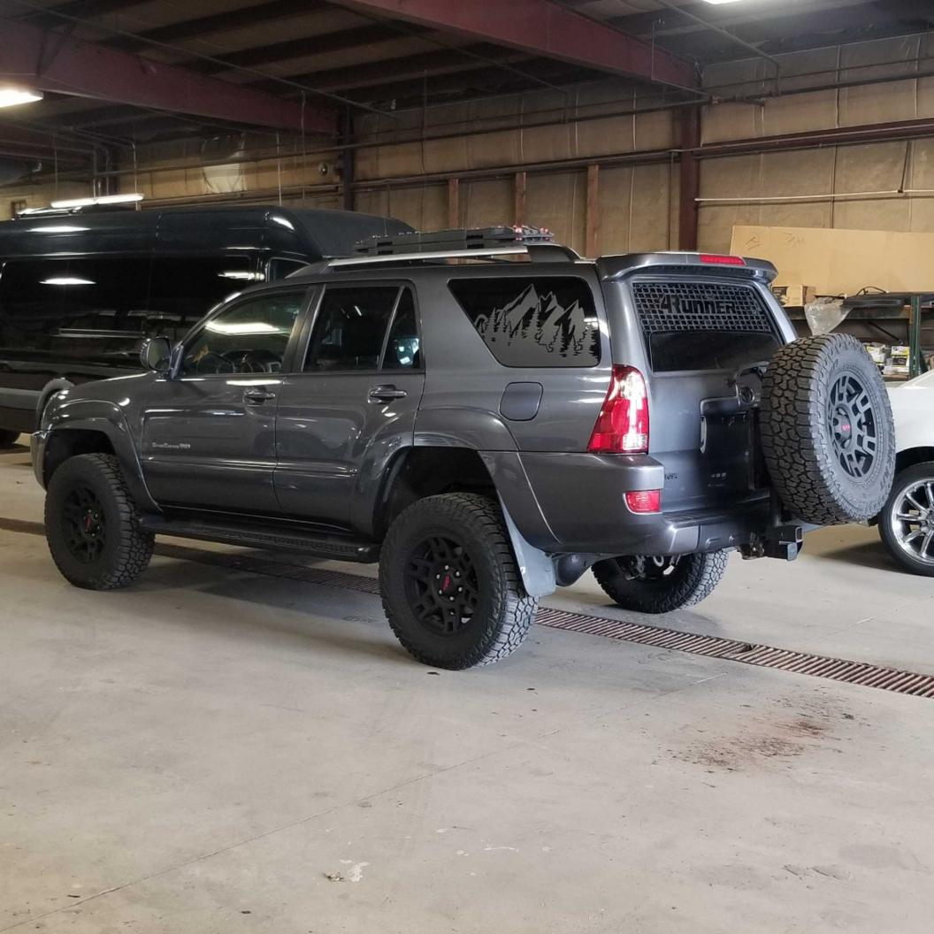

I got the toytec 2.0HDs installed... My word they a tall. Looks like I am going to go to the 2nd notch on the Bilstein 5100s up front now...
Comparison shots w/Daystar spacers... And OEM springs.

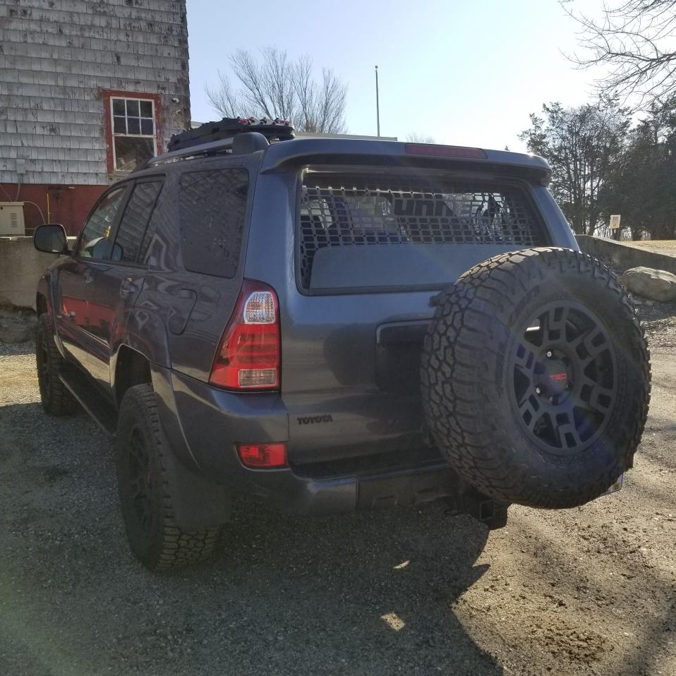

These are Toytec 2.0’s with daystar spacers and a Wilco Hitchgate. The trailer is about 175lbs tongue weight. Should be close to what you’re looking at.
-Rob

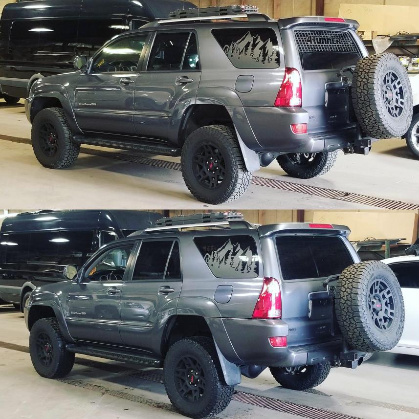

So here is where I am at now for anyone following this thread of future viewers.
I installed the Toytec 2.0HD rear springs yesterday and that brought my rear ride height to 24.5" in the rear. (measured from center of hub to bottom of fender) ... The fronts were only 22" measured the same way. That was with Toytec 2" springs in the front on Bilstein 5100's set on the lowest spring perch.
TODAY: I removed the front struts and went up 1 notch on the spring perches.
I now measure 23" from center of hub to bottom of fender.
Here is a photo of before and after so you can visualize the difference. I am happy with the result now. I have only driven it 2 miles or so but it didn't ride harsh or feel too stiff. It's interesting to see/feel how each tweak changes the behavior of the truck.
