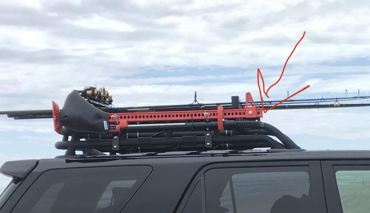

I have mine mounted on the side of the rack. I only have the jack on there when I hit the trails or the beach. I lock it when on weekend trips if I’m not staying with the truck. I just use a small piece of galvanized chain and a pad lock. I loop the chain around the top rack bar and then put both ends of the chain in the pad lock which runs through the jack (red arrow in pic shows where I lock it down). I have the chain cut to perfect length so it’s snug and doesn’t rattle around.
Wish I mounted it lower or on the driver side but I already had traction boards on the driver side. If on the driver side, I could have had the handle on top vs on the bottom.
