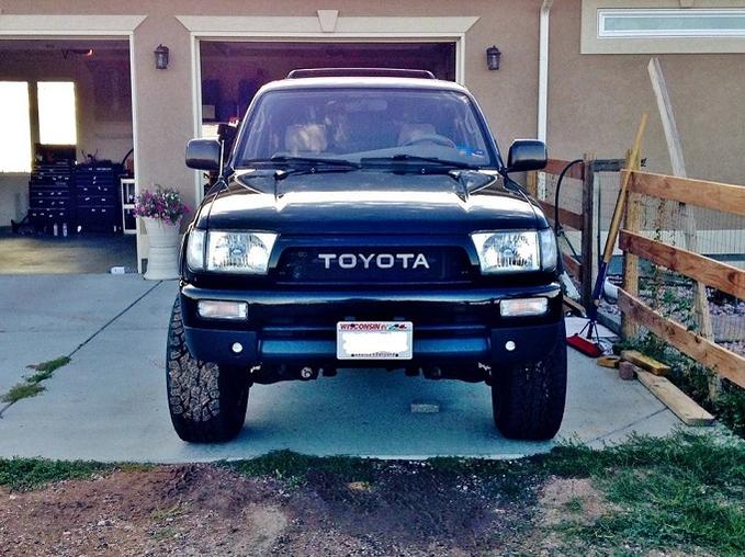

I did the hella micro de custom fog lights as well. Mine and Brilliants are basically identical. He has a link to his on his thread. The custom fog lights are the most useful mod Ive done to my truck. I work second shift, and drive home in the country every night. The stock head lights have a terrible light pattern, and with regular bulbs are not bright. So I literally use my fog lights every night. great mod for night driving. Heres mine

Sorry to bring up an old thread, but no need to create another. What are you all using for mounting brackets on these Hella fogs?
That is sweet how it was done on his older bumper. I'm wondering what people do with the '00 style bumper.
Thanks
Hella made a 2000-2002 4runner specific MicroDE kit, with mounting brackets included. Unfortunately no longer available. I was lucky enough to fine one, new and never used, on Ebay
