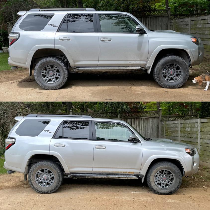

Could you post some pictures of your setup?

Click the "My Garage" Link under my Avatar before and after pics are their. The NFab side steps are a good indicator of clearance. Scroll down a bit and there is a close up of the UCA.

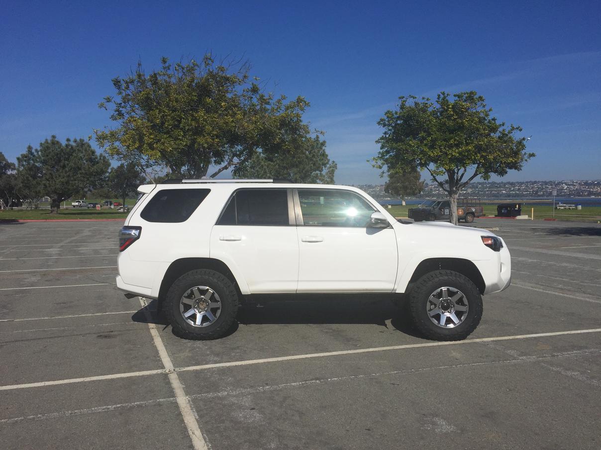

Here's mine with 6112's (circlip 4th up from bottom on 5 ring version of 6112's) and 5160's with stock springs in the rear.
