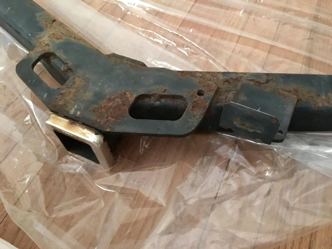

This is how bad the rust situation was on the hitch. Had to pull it in order to get it sandblasted and powder coated, and also to access the frame where it was bolted. :censored: rust!

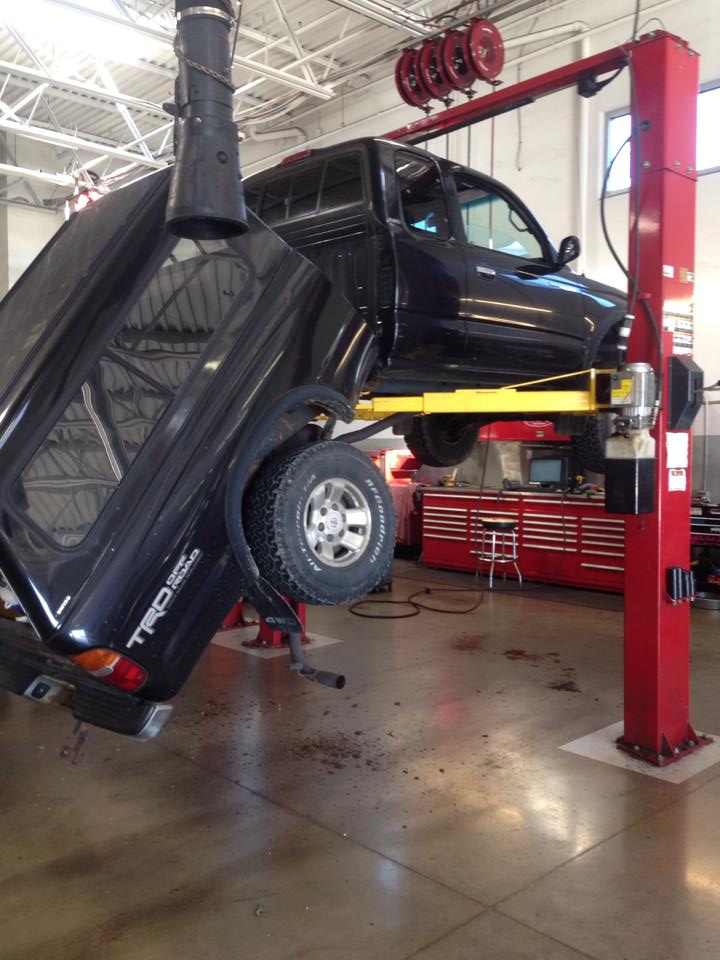

The best part about this picture is the little piles of rust under it. The tech was probably poking around like "Man, this is the worst one I've seen yet. OH ****!!!" As the truck breaks in half with him under it...

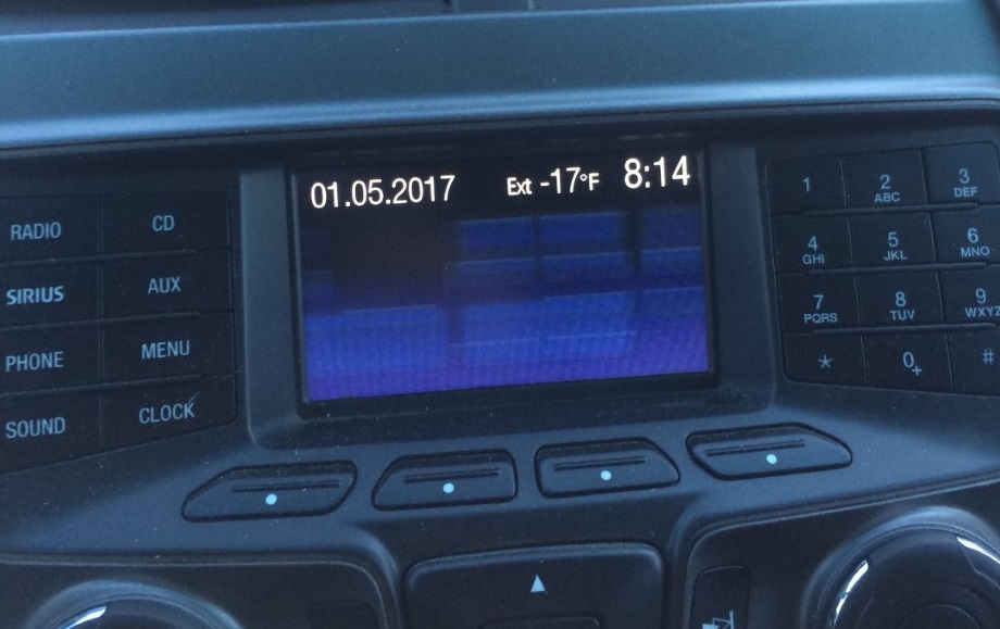

For those of us who grew up on farms/ranches we have these things called frost free valves. For those who didnt we have heat tape! LOL...Frost free is so much easier and they wont freeze if not leaking. If leaking we just plug in the heat tape.
You tell me brother...should we worry about it freezing? Took this pic about a month ago. This is not the norm...but sub zero is very common. We also use snow chains a lot...real chains...not shoe laces and jewelry chains. LOL
