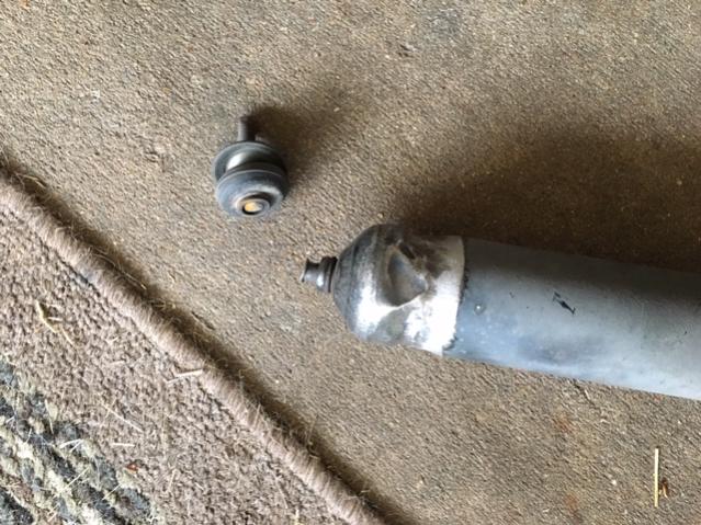

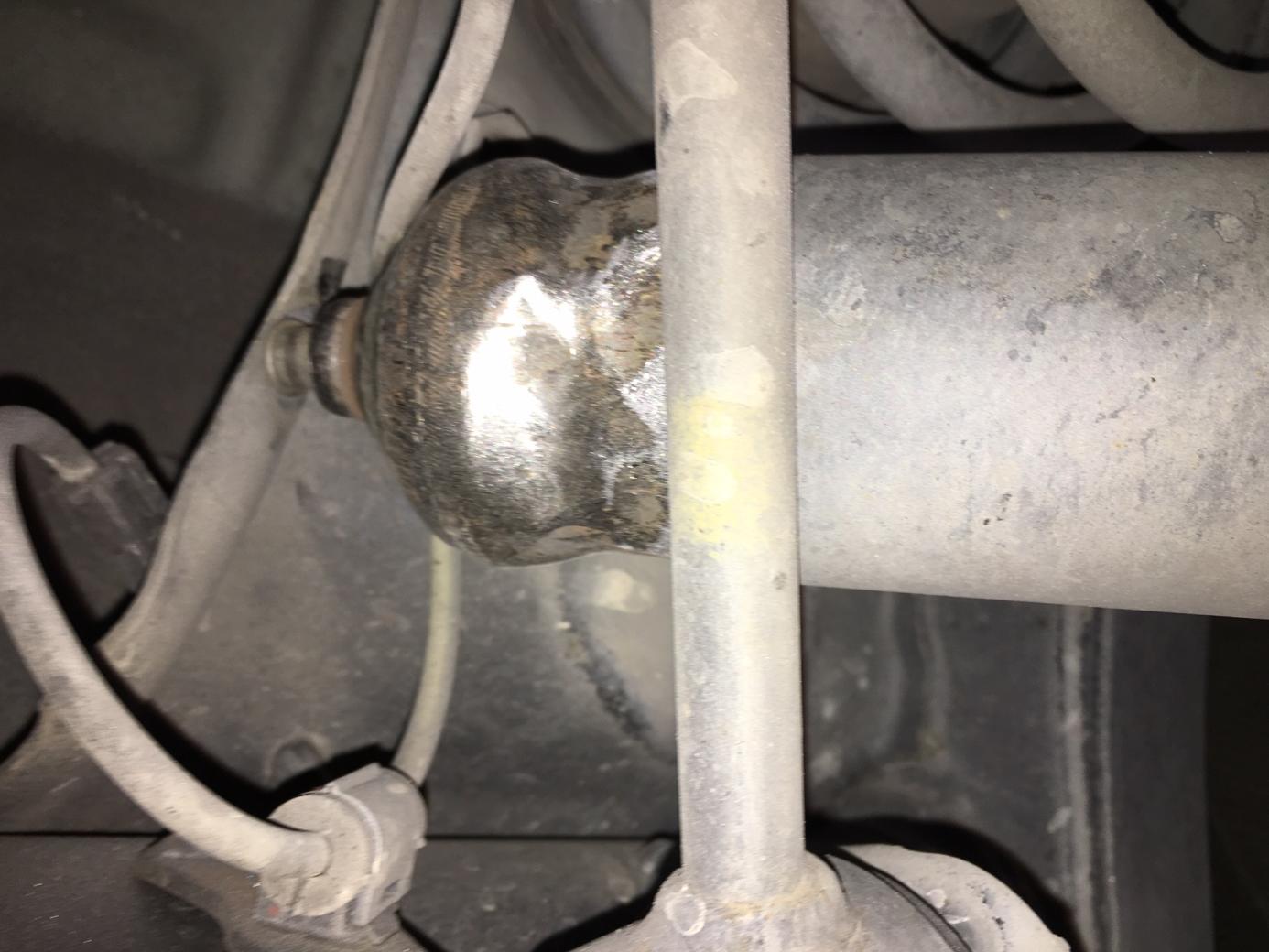

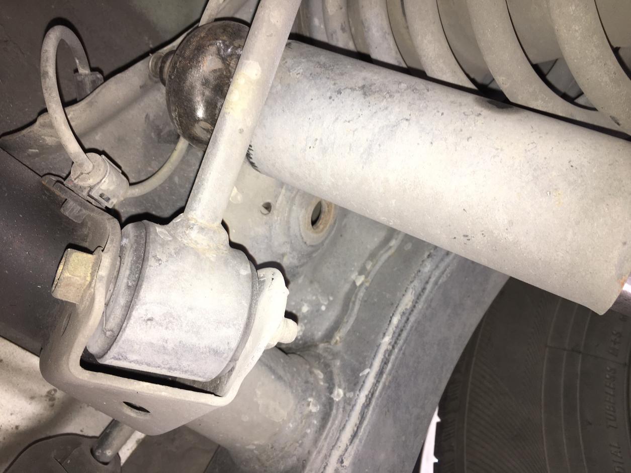

Wife’s 4Runner developed a ‘clanking’, thin-metallic bell kinda noise a few months ago from under vehicle. I climbed under there and couldn’t see anything loose. Admittedly, I’m not the brightest star in our galaxy. Then about a month ago, the ABS and Brake dash lights came on. Okay, so no braking or drivability problems and not much snow here in Texas. Then on a recent trip to Oklahoma, I noticed the rear end hopping around all-over-the-place, and we decided it was probably time for new rear shocks. I replaced front struts a couple years back, but not the rear shocks.
I researched and got a good deal on a pair of KYB Monomax shocks online, then read multiple forum posts about what a PITA it is to remove upper mounting bolt and how cutting off the top mount is much easier. I get everything ready for the job, got up under there, and found this.....needless to say, I gotta get better at my game..... And now have to replace ABS cable that fortunately was the only thing damaged. There’s just not enough Chocolate to make up for something like that

At least that side was easy to get apart! When I was installing the same Monomax shocks, I forgot to install one of the lower shock bolts. I got a few miles before I heard a 'rubbing' noise. Luckily, the shock didn't cut into the sidewall very much, more of a burn mark. The tires were only about 1 month old at the time.
I personally like the KYB Monomax on these trucks. I'm curious to see how you like them.
At least you won’t struggle with the top mount on that side. But getting that ABS harness unplugged is also a *****.
Yes it does happen. Hit a really bad pot hole on the highway 10 years ago and felt the rear end on the passenger rear bouncy got off the highway to take a look and the shock was just hanging there. Took side streets to Napa bought a set of monroe shocks and replaced them that night and what a pita had to cut the other shock with a sawzall but needed to get it done to go to work the next day.
Both my Bilstein 5100 did it. Remedy; don't tight the top nut too tight, leave some room for the stem to flex on rubber bushings.

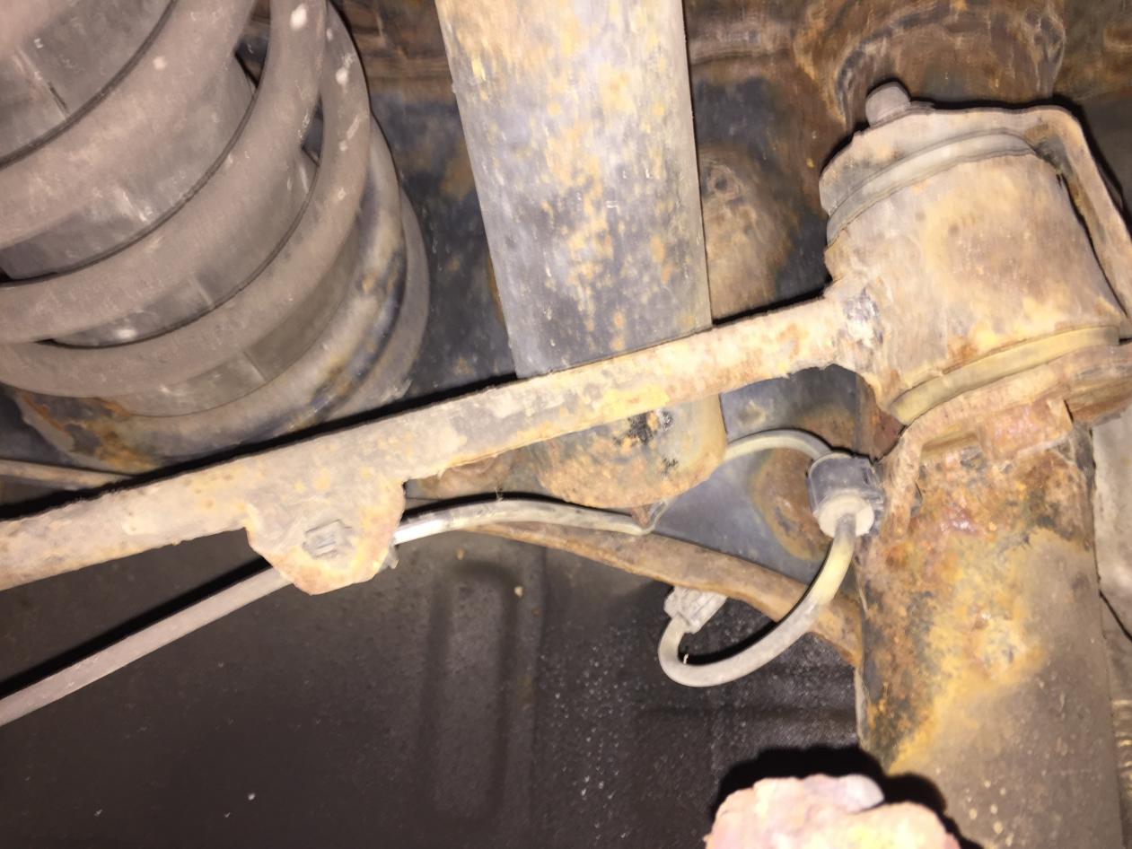

I had the same thing happen with the stock shock a couple years ago. Funny thing was, it ONLY contacted the ABS cable (as seen in the pic), which sacrificed itself to prevent any scratches to the rust patina I had spent so long perfecting.
