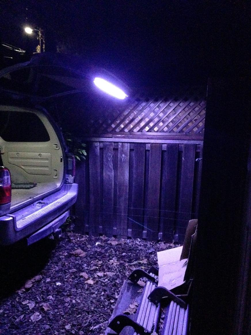

Here's it lit up.

I have the same LEDs as [MENTION=98153]MStudt[/MENTION] used. I used 6 in the rear door wired up to the rear dome light. Light output is awesome and comes in very handy when camping.
Blurry picture of the light output. I also used two of the same lights on the side of the rack.

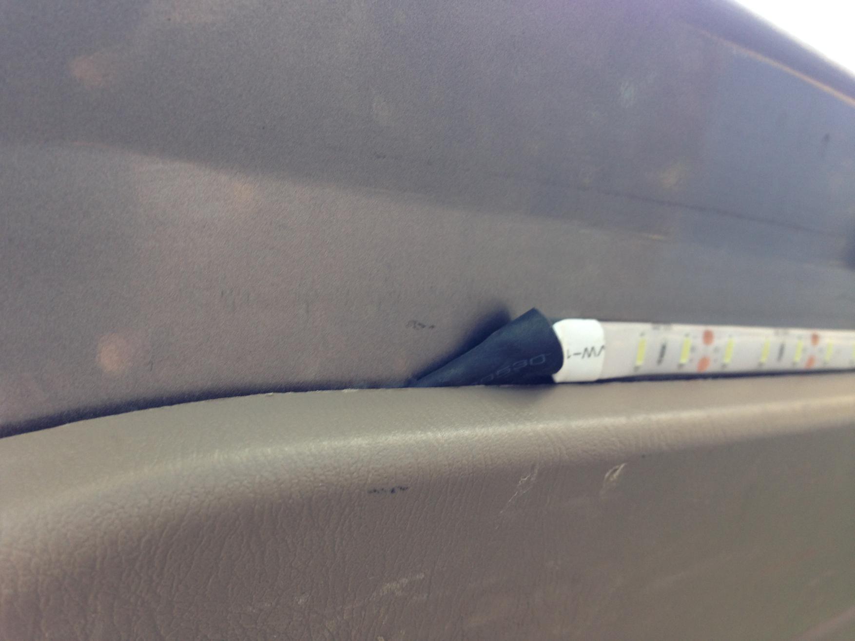

Strip of "waterproof" cool white leds from ebay. Ended up moving the strip down to the lowest point of the tail gate since these were hitting the weather stripping and letting in moisture.

A strip will give you more output. I just didn't want to deal with having it fall off. Two of the led's that I have are plenty bright for anything that I'd ever use them for.
