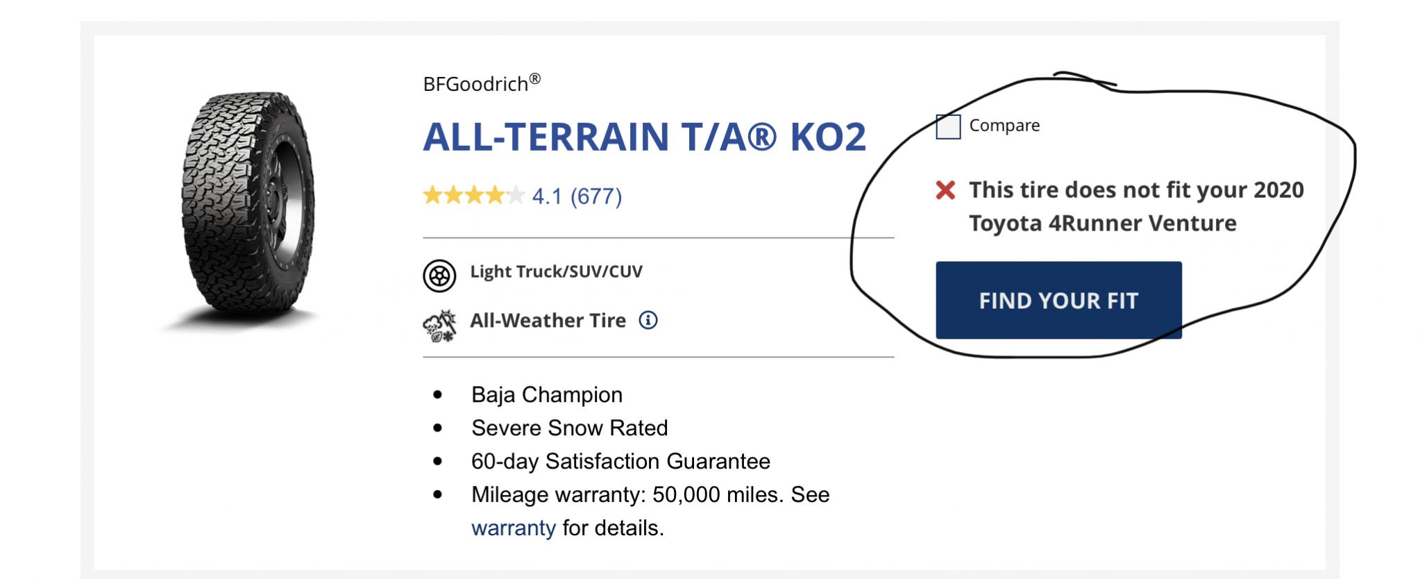

Hi Pedro,
BFG's Website said they didn't fit, which is weird as they are available in the same size as OEM.
Why wouldn't they recommend them? Where did you see or hear that from?

If you're searching for the 275/70r17 size then that would make sense since it is not the OE size and they have to put that. If it says that for the OE size then that is a mistake from their end.
They say the same thing with the OE size too because it's got a lower load rating than the stock P265 tire. C load KO2 is 112 vs. stock 113. It's a CYA thing for them.

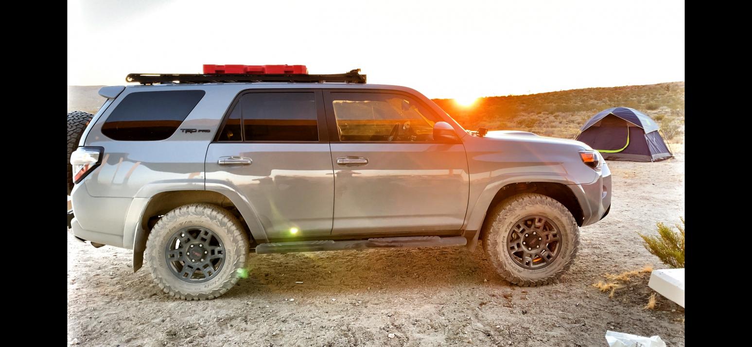

Mine is stock TRD PRO bilstein shocks with KO2s.

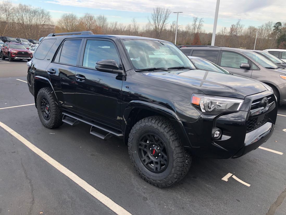

The verdict is in. 2021 4Runner SR5 stock suspension with 275/70/R17 on TRD Pro wheels. Zero rubbing with room to spare

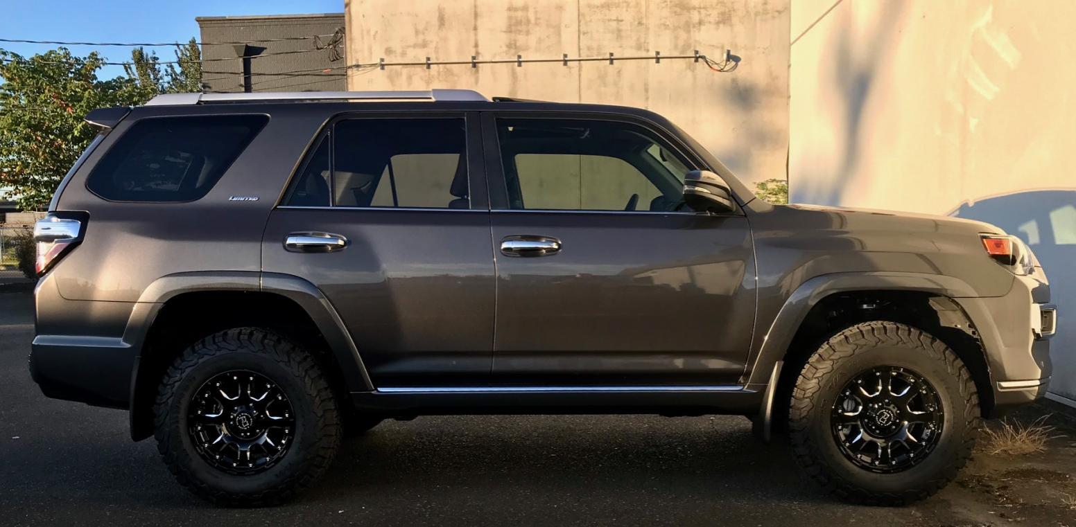

Well, it is close to no lift. Has only the 1" Cornfed spacer. This is on my 19 Limited, off with the 20" for 17X9's and 275/70/17 BFG KO2s
Hey Sawman! Exactly what I was looking for! My 275/55/20 on OEM rims are on their way out and looking to replace rim/ tire combo this time around. I do have the 1" toytec spacer up front and looking at options. I've done the fender liner mod, mud flap delete.. Are you getting any rubbing with 275/70/17?
Hello chef744:
With the fender liner mod, no rubbing for me, but I have read otherwise from others on the forum.
I have since gone to 2" front / 1" rear lift/leveling and all good now.

Thanks for the reply! That’s with the fender liner mod and the 1” cornfed level out front? And yes, been reading the same mixed feedback hence more detailed research before I pull the trigger. Although it seems the guys who were having issues with rubbing were not running a level kit at all so I’m thinking i might give it a shot with my 1” level kit up front. Fingers crossed. Otherwise it’s Bilsteins up next for me!
