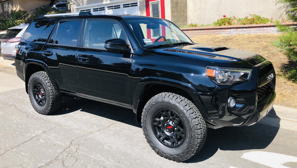

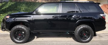

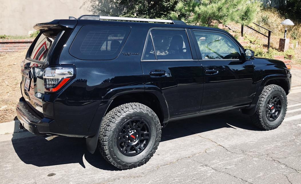

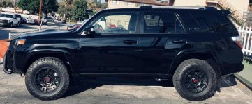

275-70-17’s without a lift

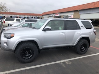

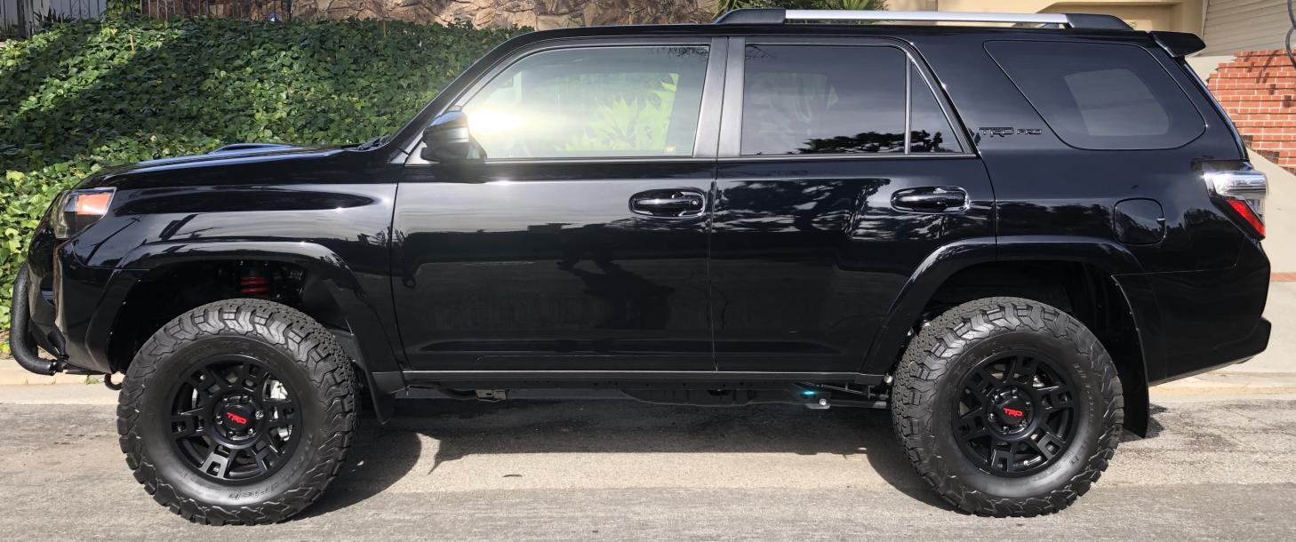

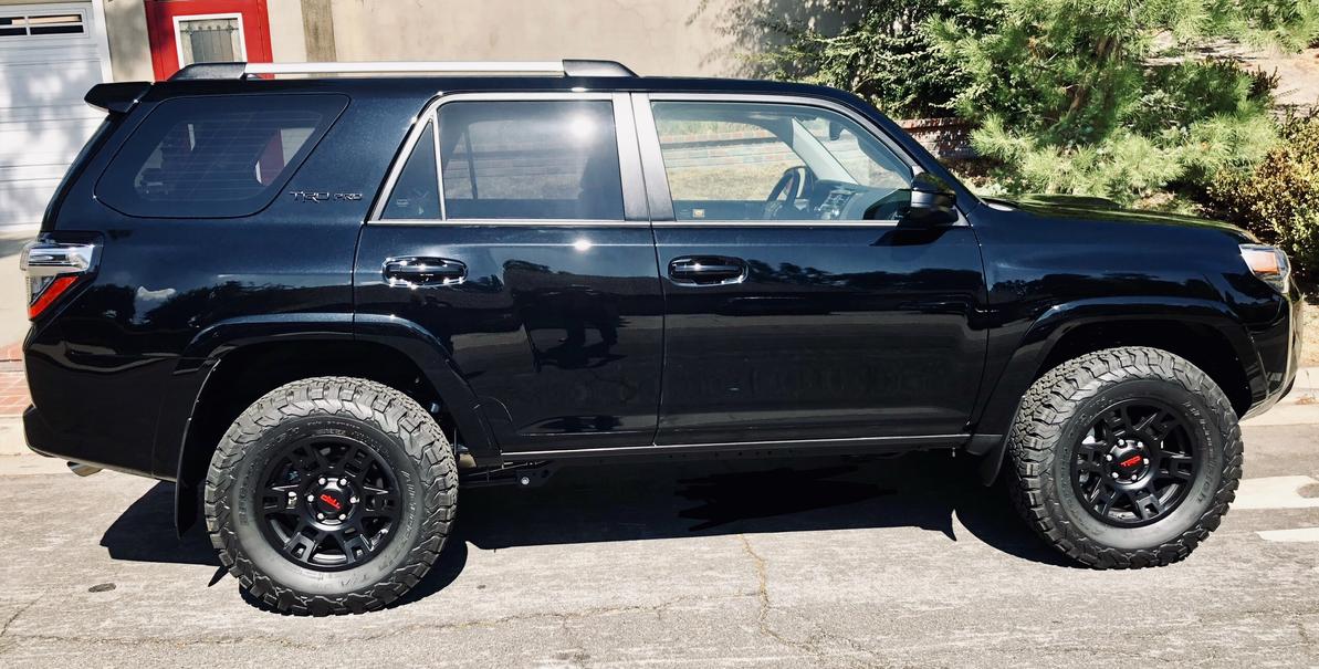

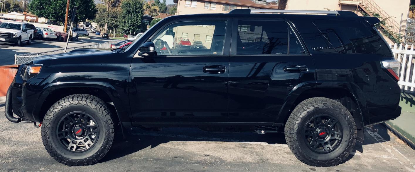

C6CE4E9B-4F7B-426F-A7A9-68C84407093E.jpgBFG AT 275-70-17’s without a lift on my TRD Pro.

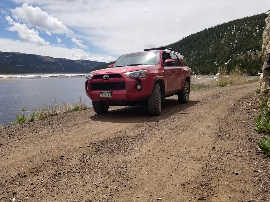

Not a great angle
But I've had no rubbing, and MPG took only about a hit of .1 MPG. My commute did change around the time I threw these on, FWIW.
I've got a slimline bumper on the truck now, and it's quite a bit heavier than stock with the winch in there, so my front end is even lower. Looking at suspension options to fix that.

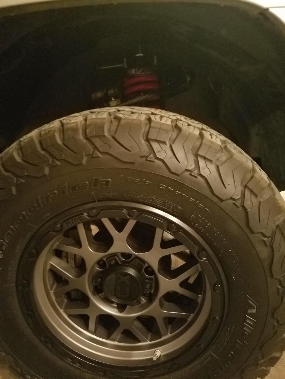

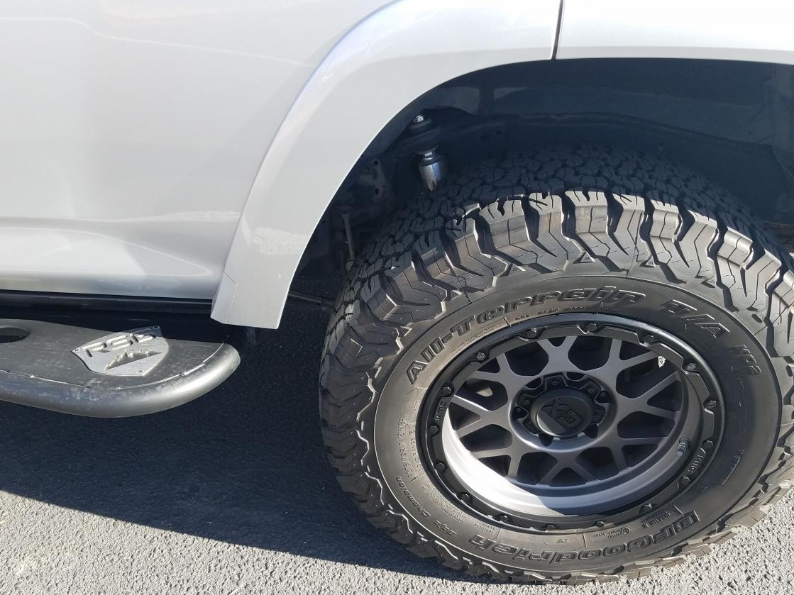

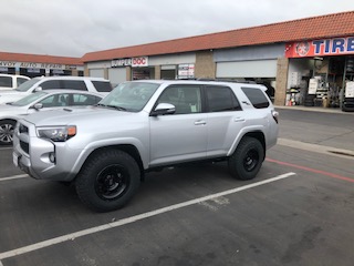

A little late, but...
Here are a few pics with 275/70/17 Ko2's with the ToyTec Boss lift. I had rubbing on the front left mud flap on full left turns at slow speeds. Removed the mud flaps and had zero issues since.

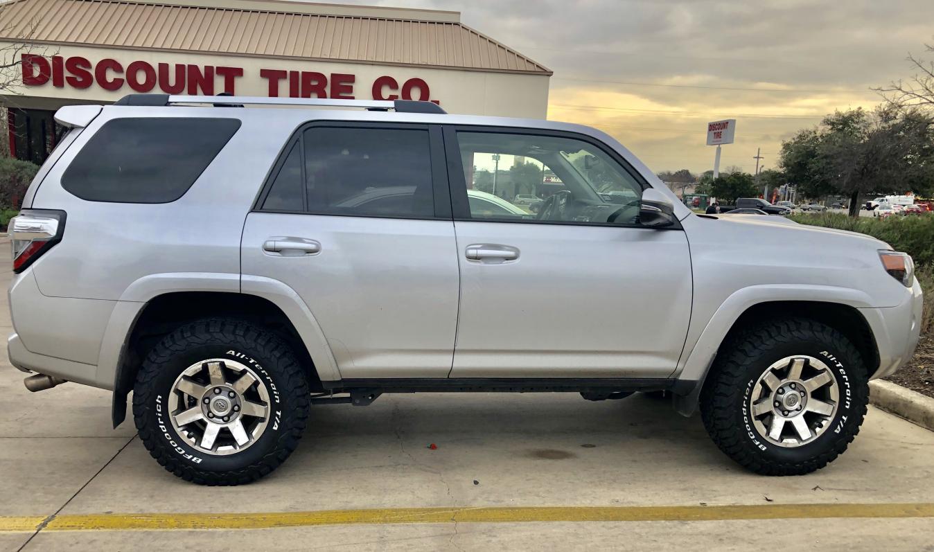

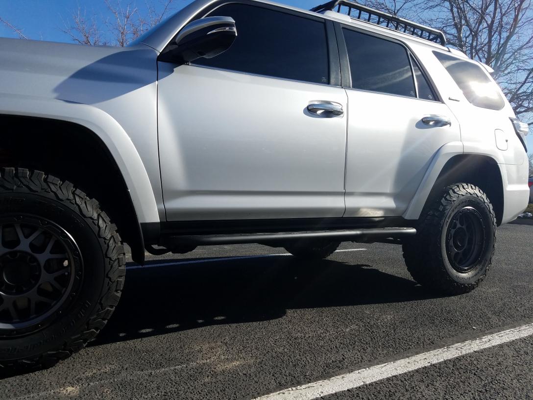

I just put on a set of AT KO2 275/70R17s yesterday. I agonized over the decision between these and the 265s, but I'm glad I went with the 275s. I haven't notice any significant drop in acceleration or power, and I actually prefer the ride of the 275s to the stock Dunlop tires. It seemed that my rig felt every little bump with the stock tires. The 275 BFGs seem to roll over bumps and potholes much easier. The one thing I have noticed is a steep MPG drop in the few miles I've driven so far. On City streets, it's around 2mpg so far. I haven't done any highway driving yet, but I'll do so and post an update.

I have noticed about a 1-1/2 mpg loss on average over the factory 265 Nittos also. They are quieter, but, ride slightly rougher. A “C” rated tire would be perfect.
