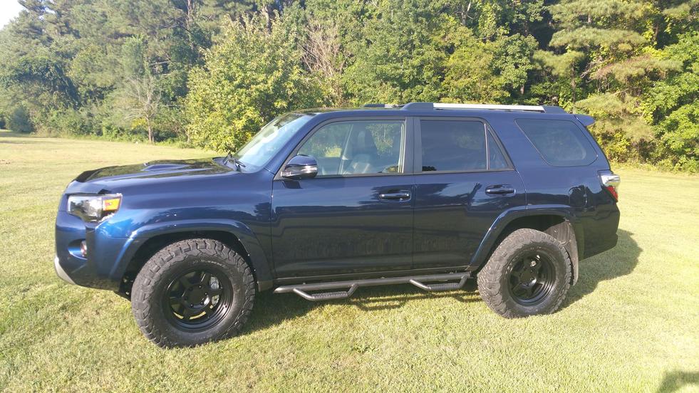

Just happened to have upgraded on Friday. Havent noticed any rubbing or noise yet.
Here you go. This was just done last week.
