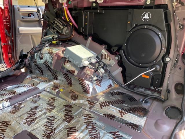

What part # did you use for the OEM sub enclosure?
Almost went with OEM Audio Plus for the plug and play feature, and got self into the audio rabbit hole and decided to go with Hertz DCX 87.3 (3.5"), DCX 165.3 (6.5") speakers, with a JL 8W3v3 sub in a Toyota OEM sub enclosure . I also installed Stinger Roadkill on all speakers, and Kilmat sound deadening to take advantage of the opportunity while panels were off. For head unit plug n play I went with Trailgridpro's Sony XAV7000 which comes with built-in amp (45RMS per channel) for door speakers.
Speaker brackets are Metra and the wiring adaptors can be found on Amazon.
Yes, requires a bit more elbow grease, but am VERY happy with the results.
Its the OEM sub enclosure with subwoofer included. As far as I'm aware there is only one OEM sub enclosure which sits behind the rear right fender. It replaced the storage cubicle in that location. The interior panel then installs back in place. Did not bother to fabricate coverings to hide the exposed portions of the sub as I like the unfinished look.
