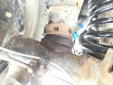

Save yourself $150. Get some extended bump stops from a late '90s GMC Jimmy. These cost me $13.

What makes you say that? Honest question. In the picture I posted, the weight of the truck is on the bump stop and the shock has not yet reached full compression. ...LC Tokico Blacks are being used.
Maybe you are talking about high-speed bumps? I don't know about others, but I don't hit things at speed that fully compress the suspension. True, a very high-speed, full-compression hit could fully compress this bump stop and destroy the shock.
*Edit: Yes, these bump stops are softer than the solid stock bump stops. But, I also went from a solid 2" factory bump stop to the softer 5.5" bump stop. I only needed an extra 2" of safety; I got 3.5" and it is softer than the factory ones.

I've seen that photo before and that's not my vehicle. I do know that with these aging bump stops, there can be some difference in the softness of each set. Let me make sure I understand what you are saying by "fully stuffed"... weight can be on one or both front tires, but the weight of the rear is fully onto one wheel with the other off the ground? Is that about right?
In my picture, I had the front wheels on the ground. I then used a jack to lift one wheel as high as it would go, lifting the entire rear of the vehicle off of the jack stands from both sides. That should be the limit of articulation, meaning that I can't get the high wheel higher off the ground (right?). Do you agree (I suspect not) or is there another type of test I should use to find the limits of the travel against the bump stops?

When I did my test for full compression with the Jimmy bump stops, I had my springs removed from the rear suspension. The springs were removed from the equation, and I consider that to be a worst case scenario test. There was nothing supporting the rear of the vehicle except the bump stop on that one side. ...and to me, I don't see compression of the bump stop that makes me concerned at all. I also don't hear a genuine reason for concern from you, aside from that photo you posted; but that looks worlds different than mine.
So tell me, from the photo I posted, do you still have reason to find concern with the bump stops I'm using? ...or is there another method (more extreme) I should use to find further compression of the rear bump stop, to test it?
*Edit: In my photo, I have both rear tires removed from the vehicle. I jacked the rear axle from the point where the rear shock attaches to the axle, lifting until the rear of the vehicle came off the jack stands; front wheels were still planted on level ground (garage).

I don't see it being an issue on your setup either. Mine seemed to stuff a lot more. I guess it comes down to you want to lower your stop with something hard like a block. Not lowered with soft rubber that can compress. Another member posted about his shocks and at full stuff with super flex his Jimmy stop looked the same. Maybe I'm just being paranoid.
