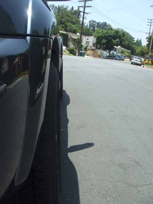

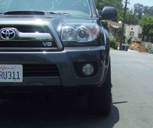

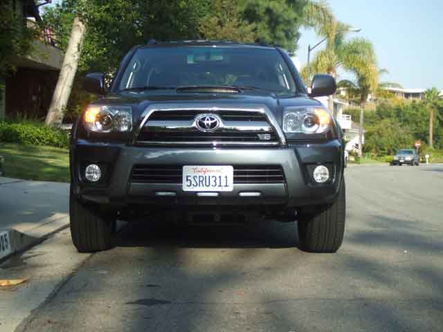

Hey mole177 can we get some pics of the truck from the front, front 3/4, rear 3/4? I'm curious to know how the spacers affect the overall look and stance of the 4Runner. :awais:
Thanks!
I ended up going with the Spidertrax Spacers. They were the only ones that were both hub-centric and anodized.
So far so good!
Here's a pic to go with:
