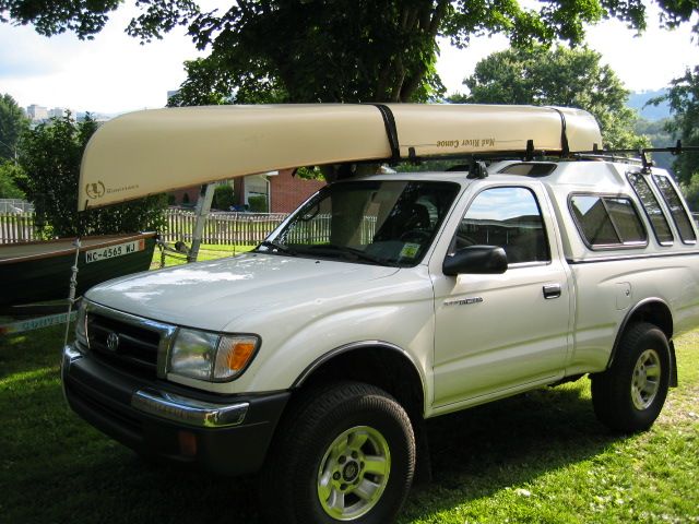

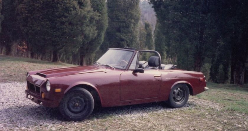

memories... used to run the dragon in a 1970 Datsun Roadster I scrapped together for autocross. fun stuff. soon after the turn of the century, I was back that way in a 2000 Tacoma 4x4 short cab. tipsy!
