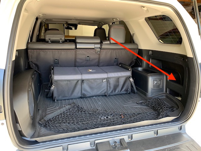

Would it work if I put the antenna that comes with the unit in the rear passenger side panel? See picture. I am assuming that it should work better than a little hand held unit, right?
Also, would it be safe, health-wise? I am assuming 15 watts coming from the other side of the windshield vs the rear cargo area wouldn't make much of a difference?

I am using the ghost antenna
FYI, you're going to have a pretty big null in your antenna coverage because of the rack. With any antenna, metal in close proximity is going to absolutely kill the radiation pattern. I'd recommend getting the can completely above the rack rails, unless you prefer the "super stealth" look over improved performance.
