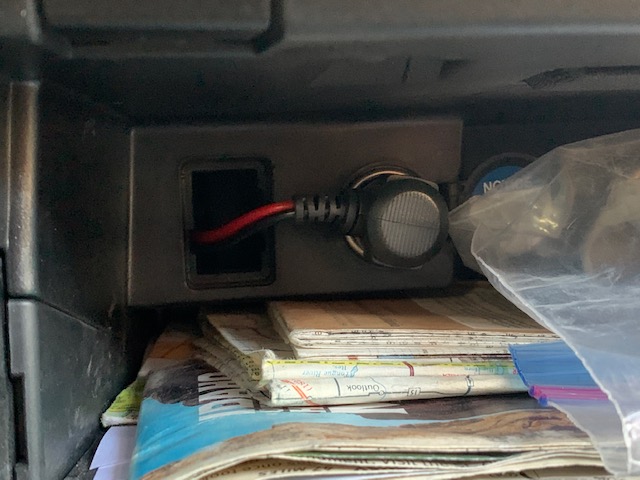

Not a big fan of cables out in the open either, I kept it simple and ran the wire over the top of the hvac and to the back of the glovebox, popped the blank out (where a usb might be on other trims) and plugged it into the 12v plug. Out of sight and easy to remove.

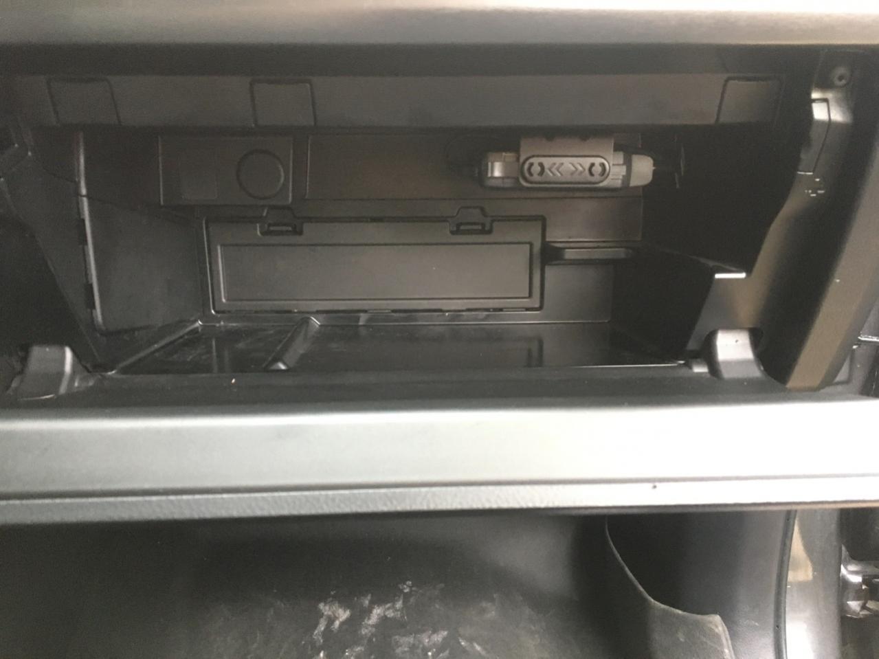

Picture :) inside the glovebox, I may of started here and fed it through, can’t remember, check to see if the plug fits through the knock-out

He popped out the blank to feed the plug out and then plug it into the 12 volt socket in the dash. The radio comes with a cigarette-lighter type plug.

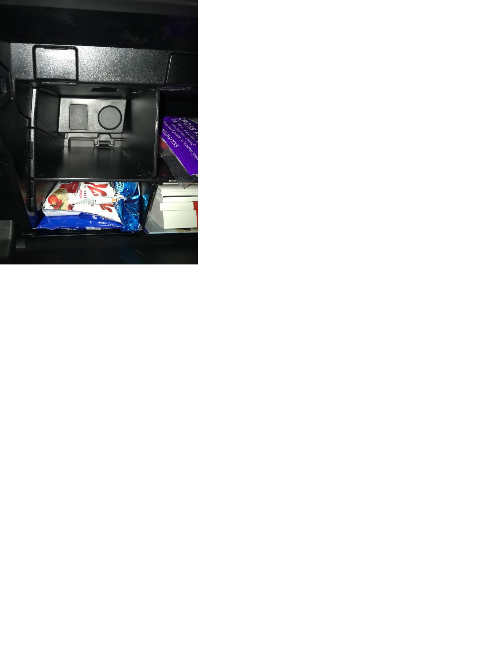

Ah, my 2021 ORP doesn't come with it from factory for whatever reason
Yep, mine doesn't either. And that's why I jumped on the idea that he had brought it out of the dash (although, I was kinda stabbing at that without looking at my own dash.)
Sorry for the misleading.
Wouldn't be too terrible to wire in a socket in there if you wanted. The holes are already there. I wonder if there's a loose connector behind the glovebox just waiting to be used?

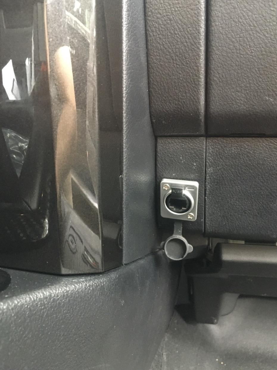

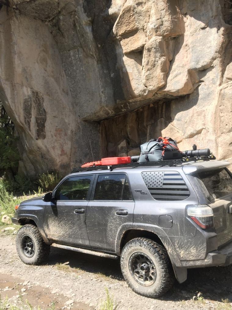

I mounted my Midland MXT275 in the glove box like shown on their website. I ran the power wire to my sPOD in the engine bay and run it via my sPOD. I bought a antenna off of Amazon that mounts on my Prinsu roof rack and can be folded down between the cross bars of the roof rack when not needed. I routed the antenna wire through the passenger side firewall and up the A-pillar.
