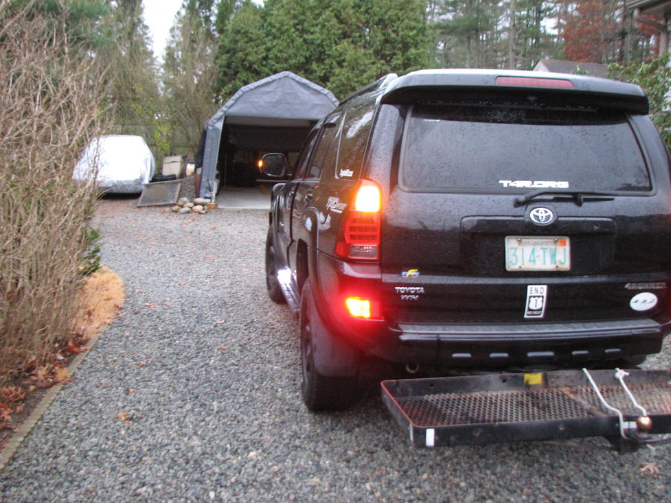

Night shot of the hazzards (Note: I have vLeds V3 switchbacks as my DLR/turn signals which is why they are very bright :) ):
9352DA90-F7F5-4AB7-AADE-C20710B13686_zpsmwqdrt47.jpg~original

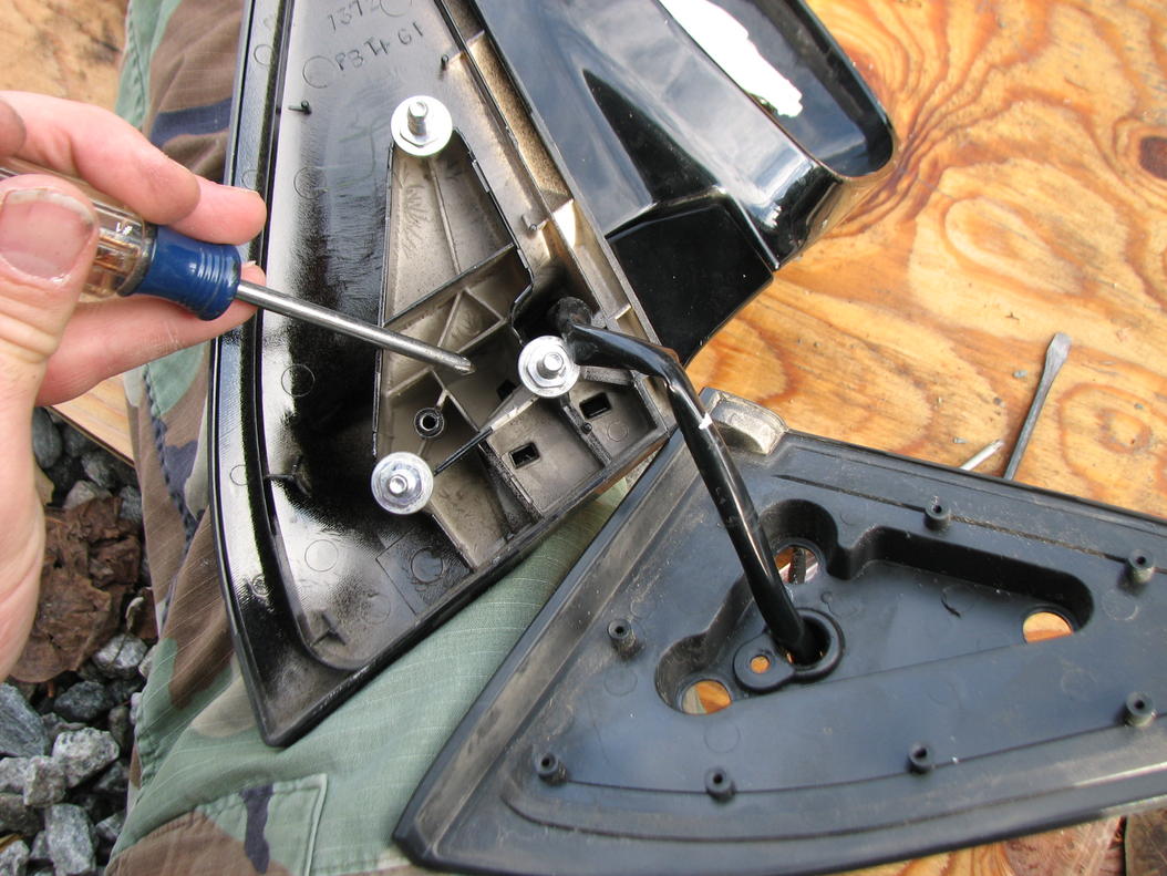

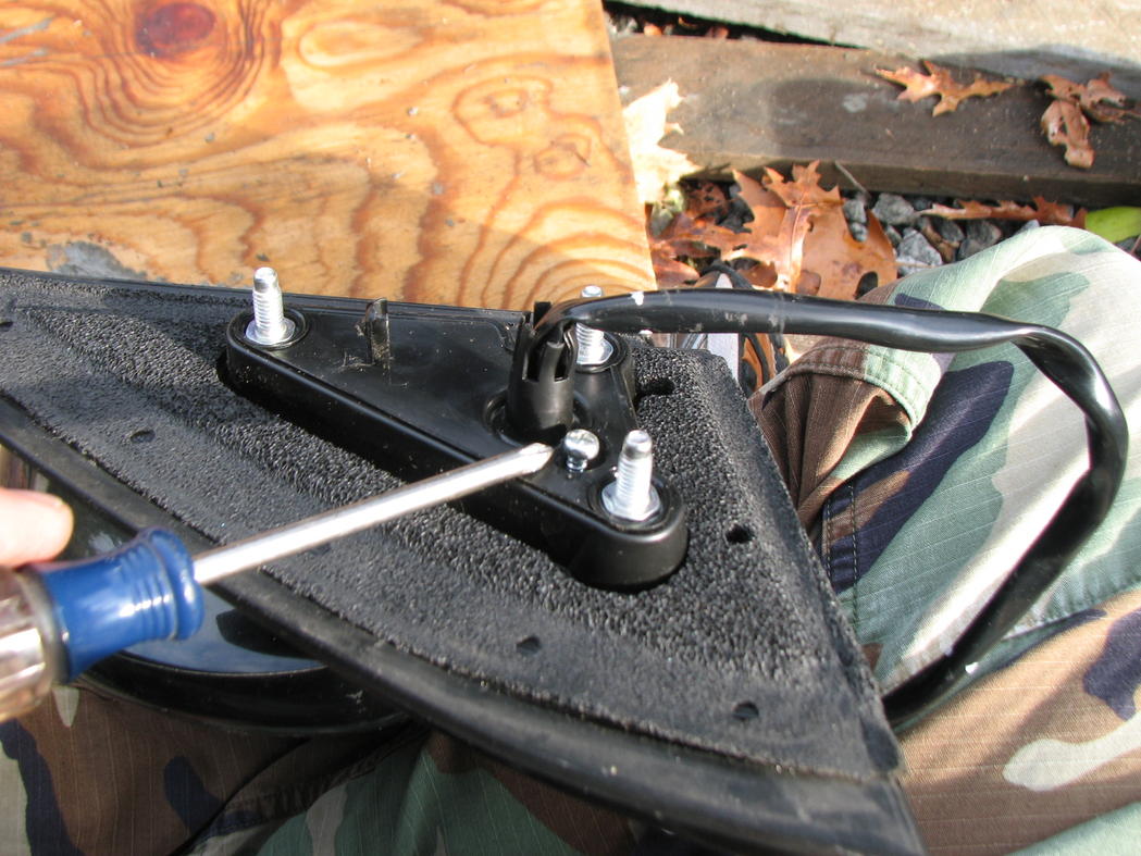

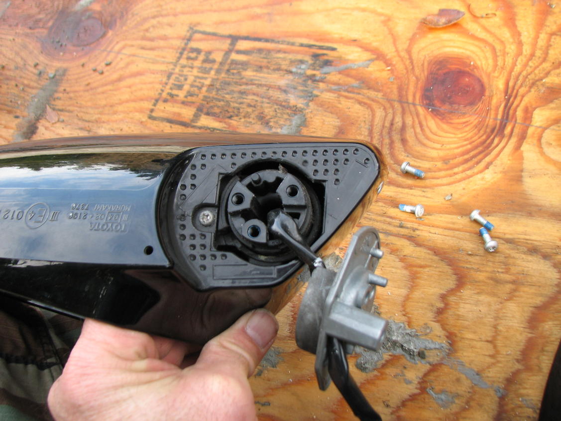

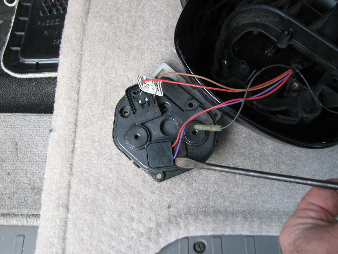

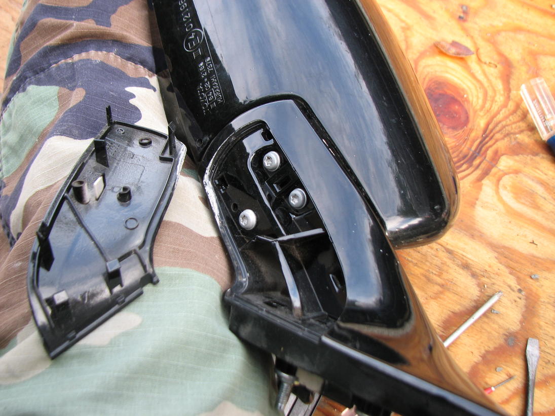

Finally getting off my arse to get these installed. Wanted to clarity a few points on the mirror removal.
Removing the door panel & mirror assembly itself was no problem. I misunderstood and thought that the mirror housing (the part we're replacing) just popped up off the bracket that is attached to the door. I'm sure if I pulled REALLY REALLY hard it would've popped off!
Once the whole mirror assembly is off, there is 1 small screw where the 3 studs are. Remove that and the whole back rubber & foam gasket will come off (you can see it off in the 2nd image). You'll have to remove the tape securing the existing harness through that rubber piece. 1st image
Next look in one of the crevices and note the tab. Push that down with a tool & a small cover can be removed from the bottom of the mirror bracket.2nd image
This will expose the 3 torx screws.3rd image
Remove them & there is 1 more underneath & 1 small screw through the mirror housing. Remove those. 4th image
Now you can remove the motor bracket from inside (3 screws). I then removed 3 more screws to remove the motor from its bracket. On the back of the motor are 4 wires with 2 connectors (2 wires each), a grey & a black. 5th image I removed the connectors then removed the wires from them (once the connectors are off it should be pretty clear how to pull the wires off). MAKE SURE YOU NOTE OR LABEL WHICH WIRE GOES WHERE. On mine was a brown & a red on one and the other had a purple & a red. I felt this was the easiest way to get the wires out of the motor bracket tube so I could swap to the new housing.
When I ran the new wires, I didn't try to fish them inside the small sleeve/loom for the existing wires. Instead, I used a length of 1/4" heatshrink for the 4 new wires.
You can now re-assemble everything. I would loosely attach the mirror to the door & ensure that it works properly.
As I think was stated above, I just tied the puddle lights into the wiring for the door panel light. Ensure proper polarity. You then just have to run the two wires for the directional the rest of the way through the door to the inside of the vehicle (or just the positive if you want to connect the ground from it to a ground wire in the door panel).

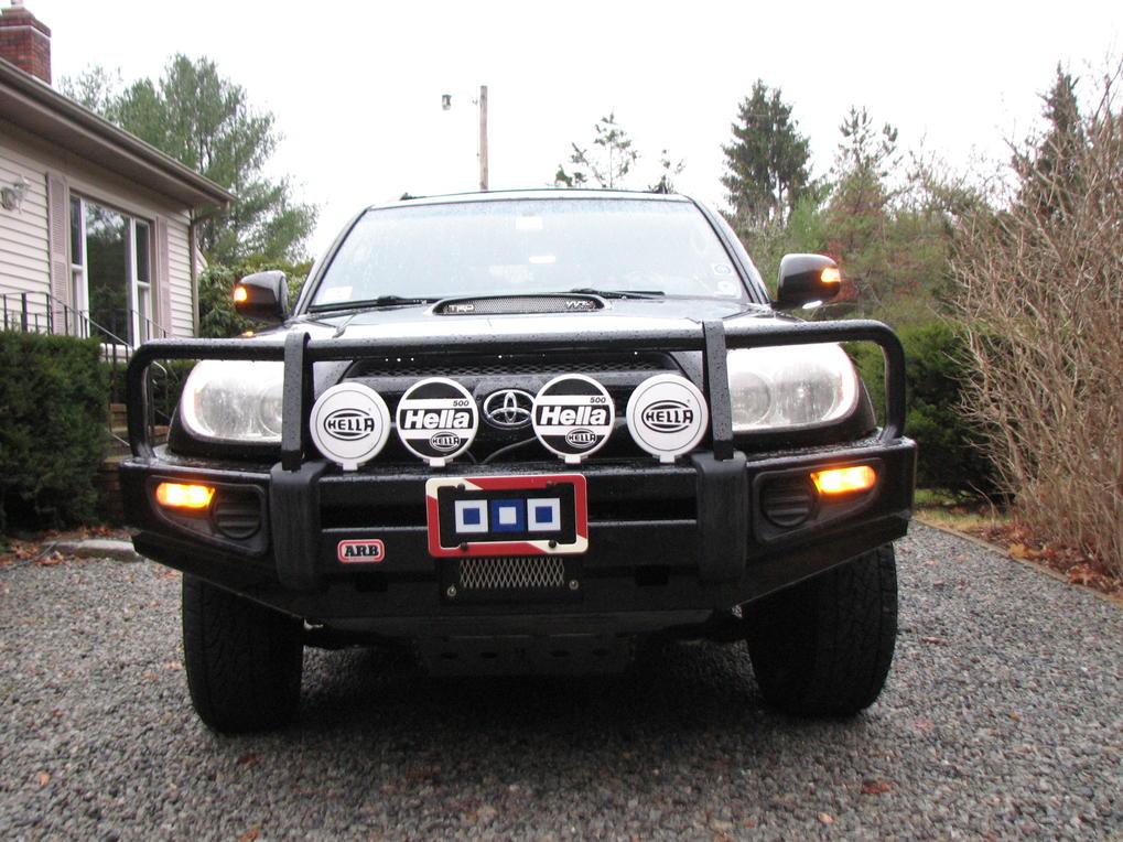

Passenger side complete & working. Really not a hard job now that I know what to do. Fortunately I had previously run a right directional circuit wire over to the passenger side from the fuse panel area some other time I had the dash apart so it was an easy connection on the pass. side.
Now for the drivers side & that should be pretty quick I'd think.
The WORST part was trying to reattach the glass mirror!
Drivers side complete. Now that I know what to do, it to me 2:30 to do it. So far very happy with results. Puddle lights are plenty bright at night.

Looks great! Did you paint the mirrors, or have them painted by a shop?
While this looks like a massive PITA, I like how visible the signal is from the blind spot.
Thanks [MENTION=50507]CookieRoe[/MENTION] for documenting this and being the sacrifical lamb.
I still want to figure out how to get the 5th gen mirrors to work....
I painted them myself with Rustoleum Automotive gloss black. They came out fine.
