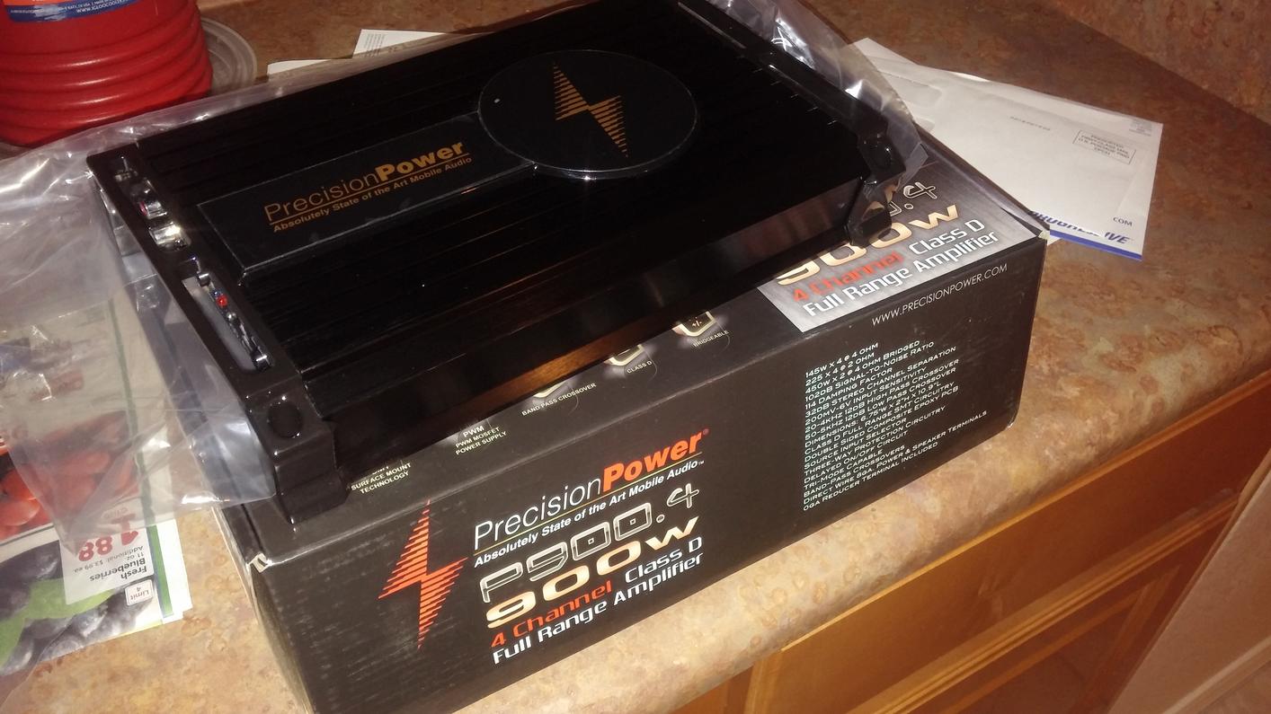

Decided on the precision power p900.4 for front stage. Test fit was perfect under passenger seat.
