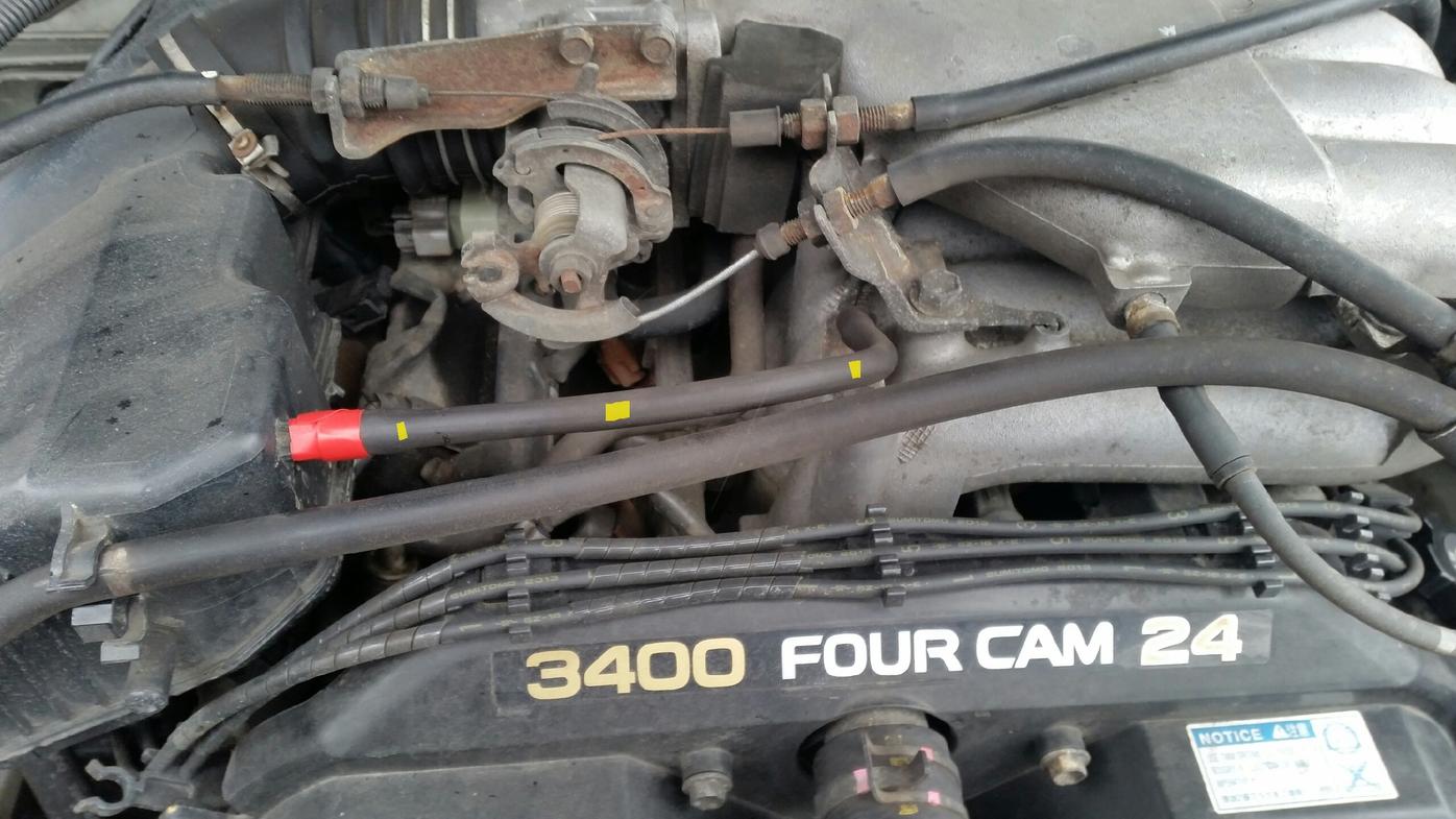

2000 Limited. I have a cracked vacuum hose. The smaller hose that connects from the intake to the manifold. The cracks are where the red tape is. I marked the hose in yellow. I'm looking for the part # so I can order it. Thanks!

It's just a vacuum line. Any silicone house will do.
I just say vacuum line. Just a silicone house from anywhere will work. Or rubber if you want.
I only said it's not a vacuum line because there's no vacuum go through it.
OP, you can use any hose you want but be aware that the nipple on the airbox is larger than the one on the metal line, so a regular piece of tubing may not fit right depending on whether you go larger or smaller in ID. Nothing like OEM parts. Just my .02 cents.
