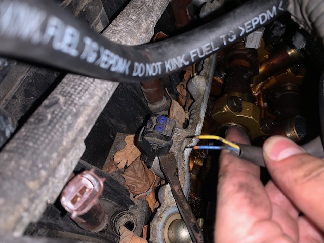

B BigMike18 Member Jun 11, 2020 #1 Was doing some dirty work in the engine, was pulling and pulled a bit too hard and lost this connector plug and Dont know the name of it? Attachments 232B2B6E-6F46-4627-9D3F-0C806B0D513B.jpeg 123.2 KB · Views: 267

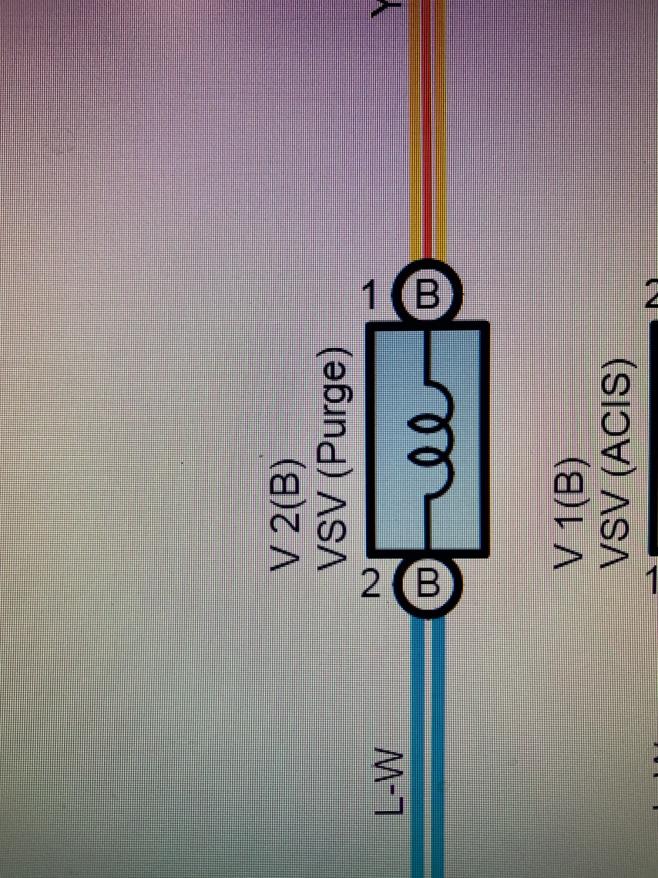

spdrcr29 New member Jun 11, 2020 #2 Looks like wiring to the purge valve that's mounted to the top driver side of the intake manifold at least if its a V8... Attachments IMG_0060.jpg 130.3 KB · Views: 234
B BigMike18 Member Jun 11, 2020 #3 spdrcr29 said: Looks like wiring to the purge valve that's mounted to the top driver side of the intake manifold at least if its a V8... Click to expand... That does sound right, thank you sir

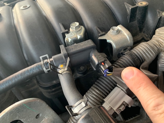

spdrcr29 New member Jun 11, 2020 #4 Here's a photo of the one on mine... Attachments IMG_0061.jpg 88.2 KB · Views: 220
