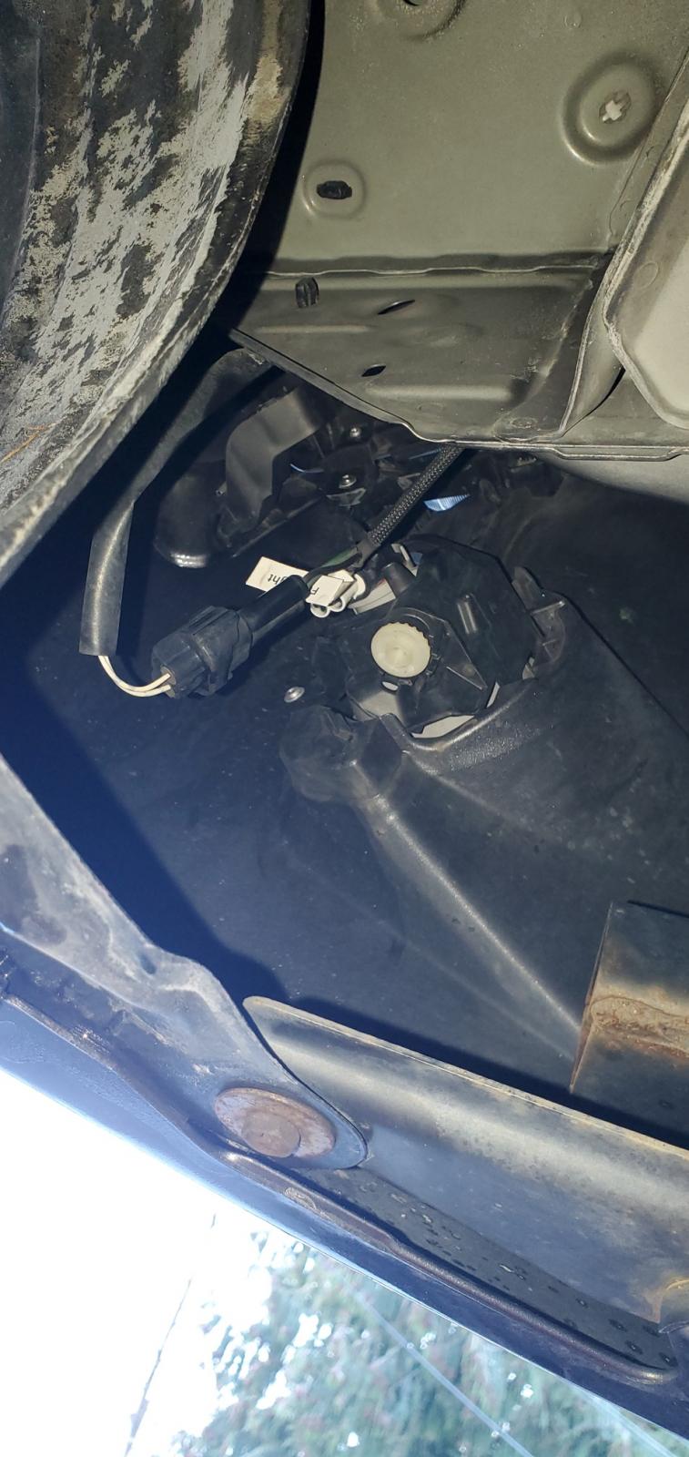

You can reach from underneath. Lots of space behind the bumper cover.

You can reach from underneath without removing the wheel well?
Yes that's right! The pic I posted was directly under the front bumper cover. I had to replace fog light bulbs and realized I could just reach under instead of through the fender liner. The passenger side may be a bit more of a challenge but I think it's still doable. Here's the video I found on the subject.

I think it was the passenger side that has a extra cover that I recall being quite a pain to maneuver around to pull out the light...
Can you get the whole housing from there or just the bulb? I need the whole thing so I can take the Lumin X tint off.
