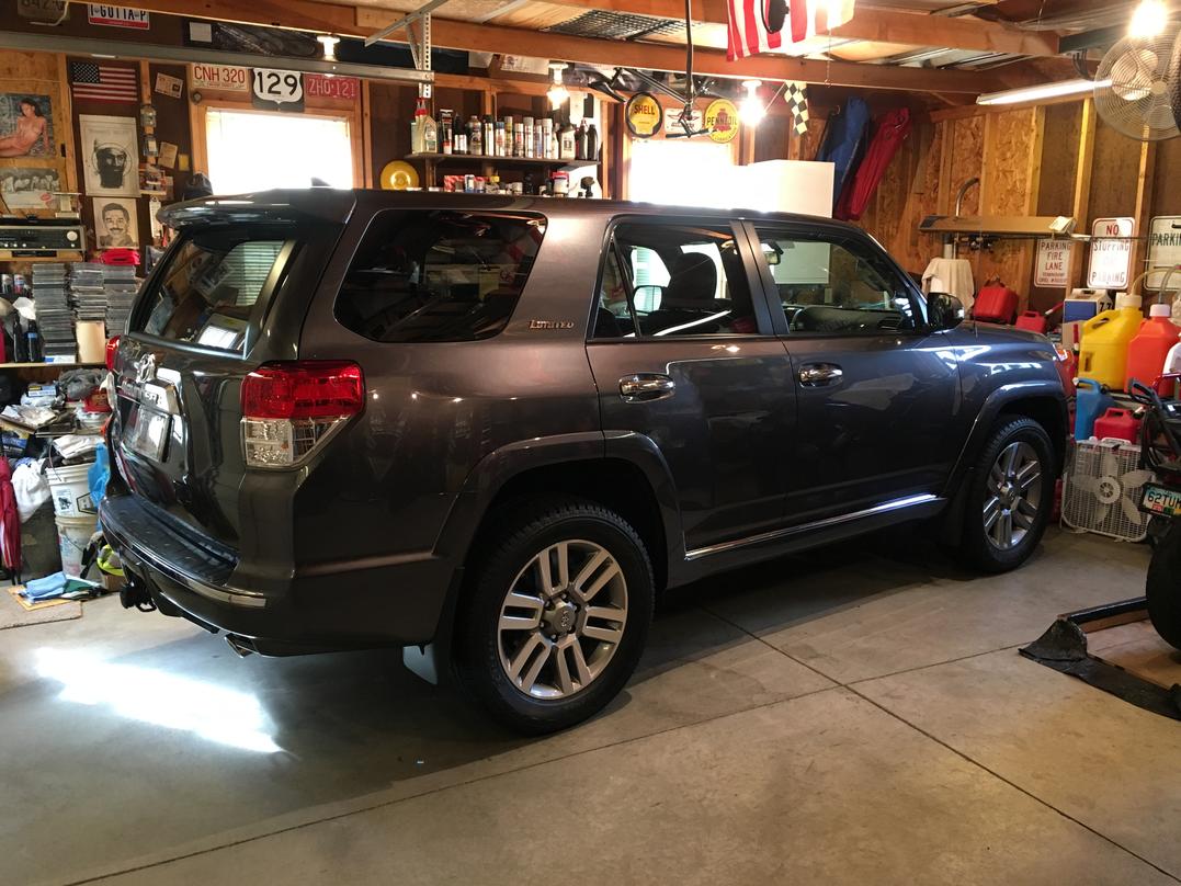

I've strayed from factory recommend tire size over the years on various vehicles with good and bad results, so anymore stay close to factory recommendation on stock rims. Had thought for a year or so I'd like to put 275's on the runner but was concerned about issues I might have as a result ; $ 1,000.00 on something I wouldn't be happy with. So it's been a little over two months now on Bridgestone Dueler Alenza Plus 275/55-20 111H. Mine is a limited with stock suspension and couldn't be happier ! No rubbing, quiet, comfortable ride with no issues. When they were getting mounted up, to see the two tires side by side ( factory 245/60-20 684 II's vs new tires ) they look massive. As many others have stated, the 275 looks perfect on a stock suspension 4Runner. Looked at many tires & brands but really wanted to go with Bridgestone since I've always been partial to them. I've had Michelins's on motorcycles and a couple cars and you really can't go wrong with a upper end Michelin but they get kind of pricey. Guess you have to figure what you're looking for in a tire and how soon you'll be replacing them . The slight extra cost may be fairly irrelevant. I priced the LTX but they were going to be over $50.00 more per tire and I kind of set a limit as to what I was going to spend on tires. Had a local shop dismount, mount, spin balance & discard old tires for $ 780.00 out the door. All smiles with my tire decision !!!
